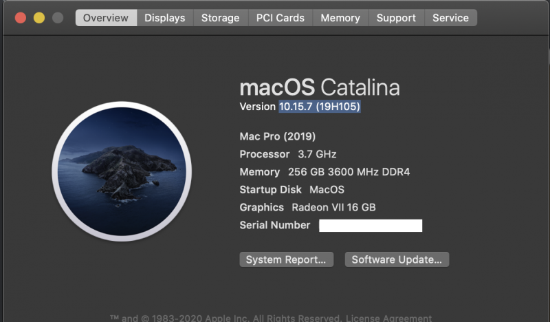

I tried, normal boot. I'm on Catalina 10.15.7 (7.15 p.m.).
I have the principle that it degreases the EFI
Do you need the debug file?
