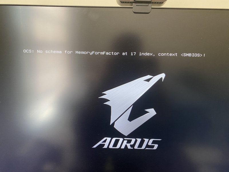

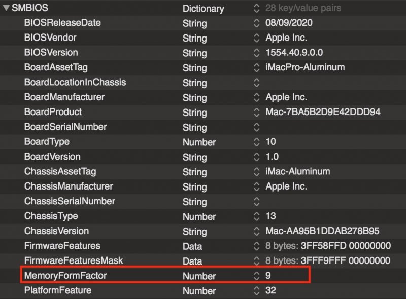

23 minutes ago, Jaidy said:
@Ploddles @meina222 this is the message it gives at boot. It was giving this message when I did exactly what @meina222 said about the upgrading procedure - simply updating the files from the OC 0.6.3. @Ploddles this error still comes up after replacing my EFI with yours..
Not getting this, but looking at the diff, here's a small difference - the highlighted key is new in OC 0.6.3 and did not exist in 0.6.2
    <key>PlatformInfo</key>
    <dict>
        <key>Automatic</key>
        <true/>
        <key>CustomMemory</key>
        <false/>
        <key>Generic</key>
        <dict>
Can you try with that?

also check this:
981269444_ScreenShot2020-11-04at7_45_55PM.thumb.png.225e1ccfc50528cdb2a4bf6cf11ee9a4.png
it is open core differences.pdf from previous version
but if you use Automatic on Yes you can skip and delete tab I have said above
Please make a config backup before! 🙂
if automatic is on yes or True as I see in @meina222post you can have only this:
DataHub and SMbios are useful if automatic is set to NO
and this from initial Opencore Release.
Delete the red square entry and your  error pos 17 msg  will be gone. No longer needed after v062.

49 minutes ago, Ploddles said:
@iGPU, where are you seeing those settings? I don't have any of it in my config.
EDIT:
Just looked at @Jaidyconfig, and see it in there. His config looks like an amalgamation of mine and his previous one, no idea where that section originated from.
@Jaidy, have you tried with just my config as is, not adding those extra bits?
Yeah I just used your EFI and the error vanished! Thanks
