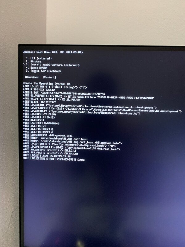

Hello @all,
I tested the most recent OC version, but it's still stuck during the macOS installation. Any advice on resolving this problem would be highly appreciated. Thank you!

I updated latest OpenCore (v1.0.1), along with Lilu.kext and VirtualSMC.kext, but the macOS installation still hangs at the start. I would appreciate any suggestions to resolve this issue. Thank you!

@fabiosun Yes, I've disabled the settings as you suggested, but it's still hanging at the same point. I'm not sure how to resolve this issue and would appreciate any suggestions you might have for installing macOS on this Asus motherboard. Thank you!
