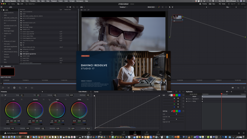

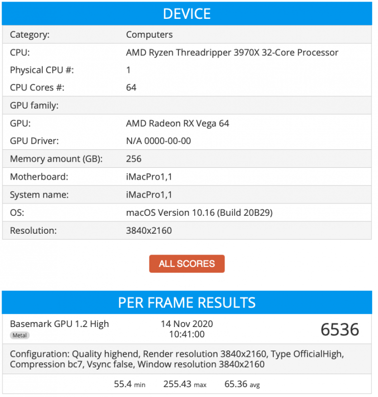

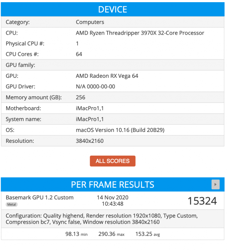

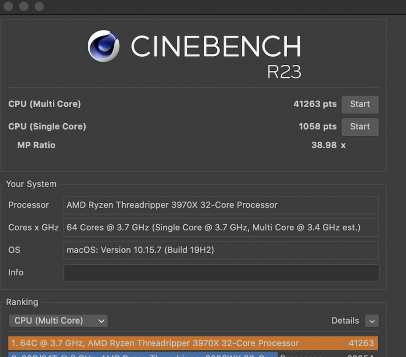

Still switch to my Proxmox boot now and again. Thought Id load up the Proxmox Catalina Cinebench 23. Here's results. Proxmox has its uses such as certain Intel primed compiled progs like Camtasia, new Davinci 17 (it flies), Adobe all compatible without hacked dylibs...etc...

@fabiosun: Thanks!  I didn't realize an AMD bare metal hack would have so many problems running my main apps like Photoshop and Davinci Resolve...:-(  I think I need to try a Proxmox install.  Do you mind re-sharing your Proxmox install guide?
For those who dont know you can share the same catalina/bs NVME INSTALL between two different EFIs for Proxmox & bare metal. ie you dont need to have two separate OS X installs.
In my case, one EFI on a USB for bare metal, and the Proxmox efi coming off the boot sector on another nvme. Keeps em safe from corruption.
But it means if you need Intel 100% compatibility apps like Camtasia (or you dont wanna dylib hax for Adobe/Davinci) you can simply reboot to Proxmox. I can update apps in both environments - within bare metal & proxmox - and when you return to the other u should have no problems and see everything.

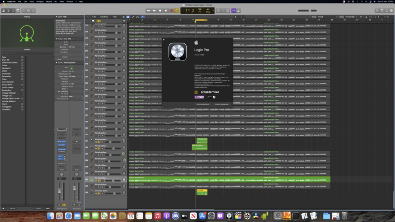

PS Logic 10.6 works fine on both Cat latest build and Big Sur.

Hmm... The DV version I downloaded this morning was 17.0B1... I will also roll back to Photoshop 21.2.4 and test it... Intel has removed the cpu_type environment variable earlier this year form the MKL library.  I think that's why these patches will not work with newer/future versions of these apps... until we manage to come up with new ways to patch them🤣
