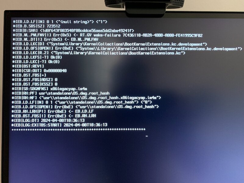

Support Team Lorys89 Posted April 8, 2024 Support Team Share Posted April 8, 2024 3 ore fa, Jerry-ag ha scritto: Hi @fabiosun, I have tried using Clover EFI, but it is not lucky and stops at the same point. flash other bios version Link to comment Share on other sites More sharing options...

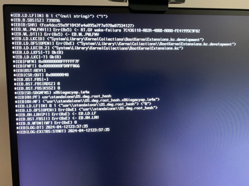

Jerry-ag Posted April 10, 2024 Author Share Posted April 10, 2024 On 4/8/2024 at 10:32 PM, Lorys89 said: flash other bios version Hello @Lorys89, Yes, I downgraded my BIOS to the last version, which doesn't have any change. I've tried many methods but still not luck. Any recommendations are welcome. Link to comment Share on other sites More sharing options...

backinblackx86 Posted April 10, 2024 Share Posted April 10, 2024 (edited) wow great score…makes me think I should have saved up for a 7970x… I came across a Reddit post of a user having trouble with their Asus…perhaps related? They mentioned a USB firmware update from ASUS that can only be done from Windows. The ASUS support page: https://www.asus.com/motherboards-components/motherboards/workstation/pro-ws-trx50-sage-wifi/helpdesk_bios?model2Name=Pro-WS-TRX50-SAGE-WIFI conveniently mentions that we need to run some ".exe" file to update USB firmware. Edited April 10, 2024 by backinblackx86 1 1 Link to comment Share on other sites More sharing options...
Moderators tomnic Posted April 10, 2024 Moderators Share Posted April 10, 2024 Probably some issues with kernel patches as MMIO whitelisting have been investigated and implemented... Some serial debugging must be done for this specific mainboard: probably only a specific patch must be refined or other ones created from scratch. Without having your exact hardware and a serial debugger it is very difficult to help you right now. Probably you can try the Proxmox way, same performance, only a bit more complicated: 1 Link to comment Share on other sites More sharing options...
backinblackx86 Posted April 10, 2024 Share Posted April 10, 2024 CaseySJ over at amd-osx said “Have all the usual factors been checked, such as: CFG-Lock — this is usually not a problem on AMD, but we can always compensate by enabling Kernel quirks AppleCpuPmCfgLock and AppleXcfmCfgLock It is also possible that OpenRuntime.efi is not able to find/calculate slide value” Link to comment Share on other sites More sharing options...
Jerry-ag Posted April 10, 2024 Author Share Posted April 10, 2024 42 minutes ago, backinblackx86 said: wow great score…makes me think I should have saved up for a 7970x… I came across a Reddit post of a user having trouble with their Asus…perhaps related? They mentioned a USB firmware update from ASUS that can only be done from Windows. The ASUS support page: https://www.asus.com/motherboards-components/motherboards/workstation/pro-ws-trx50-sage-wifi/helpdesk_bios?model2Name=Pro-WS-TRX50-SAGE-WIFI conveniently mentions that we need to run some ".exe" file to update USB firmware. Hi @backinblackx86, Thank you for the information. Perhaps the issue lies with the USB firmware, but I am unsure how to fix it. Please let me know if you have any ideas regarding this problem. Link to comment Share on other sites More sharing options...
Supervisor fabiosun Posted April 10, 2024 Supervisor Share Posted April 10, 2024 4 minutes ago, Jerry-ag said: Hi @backinblackx86, Thank you for the information. Perhaps the issue lies with the USB firmware, but I am unsure how to fix it. Please let me know if you have any ideas regarding this problem. could you post latest config.plist we did for you? only config.plist Link to comment Share on other sites More sharing options...
Jerry-ag Posted April 10, 2024 Author Share Posted April 10, 2024 10 minutes ago, backinblackx86 said: CaseySJ over at amd-osx said “Have all the usual factors been checked, such as: CFG-Lock — this is usually not a problem on AMD, but we can always compensate by enabling Kernel quirks AppleCpuPmCfgLock and AppleXcfmCfgLock It is also possible that OpenRuntime.efi is not able to find/calculate slide value” Thank you. Let me try to enable these quirks, hope it works. 4 minutes ago, fabiosun said: could you post latest config.plist we did for you? only config.plist Hi @fabiosun, Here is a latest config.plist which I received from @Lorys89. config.zip Link to comment Share on other sites More sharing options...
Supervisor fabiosun Posted April 10, 2024 Supervisor Share Posted April 10, 2024 config.plist.zip @Jerry-agcan you try this with that EFI remember always seriaql OFF in bios Link to comment Share on other sites More sharing options...
Jerry-ag Posted April 10, 2024 Author Share Posted April 10, 2024 8 minutes ago, fabiosun said: config.plist.zip 6.53 kB · 0 downloads @Jerry-agcan you try this with that EFI remember always seriaql OFF in bios Thank you @fabiosun. I will try it now and let you know the results. Link to comment Share on other sites More sharing options...
Jerry-ag Posted April 10, 2024 Author Share Posted April 10, 2024 43 minutes ago, fabiosun said: config.plist.zip 6.53 kB · 1 download @Jerry-agcan you try this with that EFI remember always seriaql OFF in bios Hi @fabiosun@backinblackx86, I have tested with this config.plist, which has enabled kernel quirks AppleCpuPmCfgLock and AppleXcpmCfgLock. There is no change; it remains stuck at the same point. Link to comment Share on other sites More sharing options...
Supervisor fabiosun Posted April 10, 2024 Supervisor Share Posted April 10, 2024 (edited) 39 minutes ago, Jerry-ag said: Hi @fabiosun@backinblackx86, I have tested with this config.plist, which has enabled kernel quirks AppleCpuPmCfgLock and AppleXcpmCfgLock. There is no change; it remains stuck at the same point. Yes i knew it but i wanted to take @backinblackx86advice so he is happy 🙂🙂 also calculate slide area is not an option because your debug said you have it available and well calculated i am out of any smart idea for now to test! 😞 Edited April 10, 2024 by fabiosun 1 Link to comment Share on other sites More sharing options...
Jerry-ag Posted April 10, 2024 Author Share Posted April 10, 2024 20 minutes ago, fabiosun said: Yes i knew it but i wanted to take @backinblackx86advice so he is happy 🙂🙂 also calculate slide area is not an option because your debug said you have it available and well calculated i am out of any smart idea for now to test! 😞 Hi @fabiosun, I am grateful for your assistance; I have gained valuable knowledge from you. However, the issue with the Asus motherboard is complex. Hopefully, we can find a solution soon. Thank you! 1 1 Link to comment Share on other sites More sharing options...
backinblackx86 Posted April 11, 2024 Share Posted April 11, 2024 (edited) kind of think of it, my MsI B550 5900x build has a similar symptom as this ASUS, it hangs at the same exact point where it won’t boot Monterey, yet Sonoma and Ventura are fine. Could it be a similar cause. Have you tried older OS? Edited April 11, 2024 by backinblackx86 1 Link to comment Share on other sites More sharing options...
Supervisor fabiosun Posted April 11, 2024 Supervisor Share Posted April 11, 2024 MSI board for AM4 has a similar problem like AM5 platform but it is not related (IMHO) with @Jerry-agproblem 1 Link to comment Share on other sites More sharing options...
Jerry-ag Posted April 12, 2024 Author Share Posted April 12, 2024 14 hours ago, backinblackx86 said: kind of think of it, my MsI B550 5900x build has a similar symptom as this ASUS, it hangs at the same exact point where it won’t boot Monterey, yet Sonoma and Ventura are fine. Could it be a similar cause. Have you tried older OS? Yes, I tried to boot to install with Ventura and Sonoma, and even with Bigsur too. Link to comment Share on other sites More sharing options...

Jerry-ag Posted April 12, 2024 Author Share Posted April 12, 2024 7 hours ago, Lorys89 said: test this : EFI.zip 8.65 MB · 1 download EFI 2.zip 8.65 MB · 1 download EFI 3.zip 8.65 MB · 1 download EFI 4.zip 8.65 MB · 1 download Hello @Lorys89, Thank you for your EFI files. I have tested all of them, but it still hangs at the same point. Note that I tried using another EFI from my Dell workstation (successful installed with Sonoma) for testing, but it encountered the same problem. That's very weird. Link to comment Share on other sites More sharing options...
