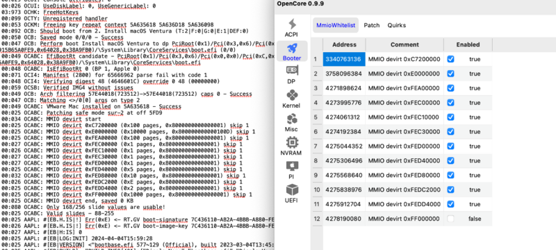

@Jerry-agi do not see your debug log (opencore.txt to check your MMIO areas)
try to modify the EFI posted above (core counts and MMIO)
check also if your motherboard bios is well configured
UEFI on
4g on
CSM off
the main part to check
@Jerry-agcheck here
there is something wrong
config plist say false but log say skip 1 for latest MMIO Area
later i could modify for you posted EFI (from me to other users)
but if you can try to adapt it for your system (mmio and cores count)
Sorry, I forgot to inform you that all the MmioWhitelist were set to TRUE when debugging for the opencore.txt file. However, this caused the system to no longer boot. Subsequently, I tried to disable the latest Mmio following the EFI folder provided by @backinblackx86, but it is still stuck at the same point.

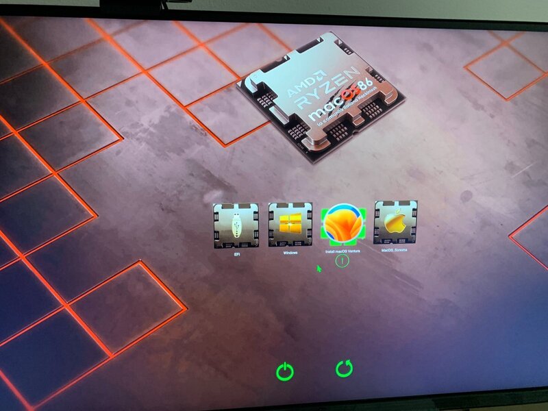

i see a ventura installer and a MacOs Sonoma icon?
is it there Sonoma installed?
Have you pressed in opencore ghraphical menu space bar and reset Nvram and sip from there?
4 minutes ago, fabiosun said:
mmmh
No, an NVME drive includes the macOS Sonoma icon, which was installed from my Dell workstation. However, I plan to format and reinstall a new one on this PC (AMD cpu). Sorry, I forgot to mention that to you.
