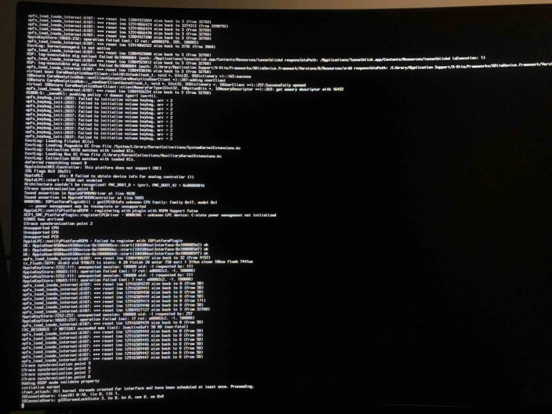

BTW. I am using Big Sur running on Proxmox. Do I have to change something in bios?

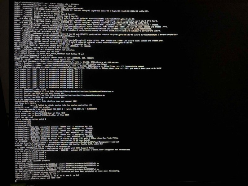

No. I don't use Proxmox to boot Baremetal. I have Proxmox on separate HDD and now I am trying boot baremetal from usb stick efi.
Some potencial important information:

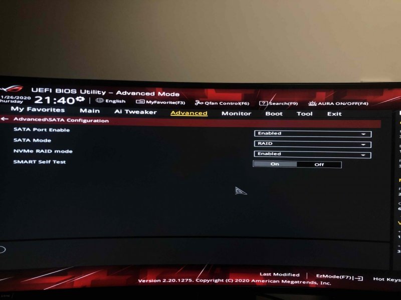

- I have 2 GPU. RTX2080s (for Windows) and Vega56 (for macOS. It is working on macOS using Proxmox). For booting I use RTX2080 as primary GPU (because I can't change which GPU is primary in bios. Physical switching is needed).
- I have set SATA in RAID mode (because I use 2x NVMe SSDs in RAID0 in Windows). RAID mode is allowed for NVMe disks too.
Sata/NVMe bios configuration:
Asus + config:
Asus + config2/acpi_config:
Edited by jasin755

@fabiosun I tried nv_disable=1 and physical disconnect nvidia card and it doesn't help. Log is same "Asus + config"  mentioned above and on end of log I got black screen. I tried all combiantions of disable/enable 4G and disable/enable CSM.
@jasin755 black screen is different of previous thing you posted?
Vega is connected to a monitor?
if so during black screen could you try to change on it dp or Hdmi port?
also could you try enabling or disabling pikera boot arg and Whatevergreen kext?
