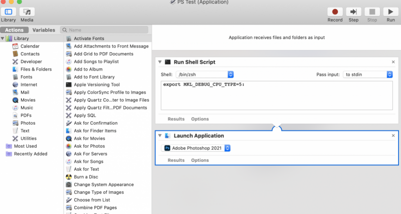

I've never used MatLab but you can try one, the other, or both of these:-
Apply the AMD Adobe patches to Matlab (change what folder the scripts looks for to patch, ie change Adobe* to MatLab* or whatever it is called)
If memory servers me right, which it doesn't always do 😀, PS etc use some of the same MKL libraries as MatLab.
Use a script, as below, to launch MatLab, try values 5 or 2.
Edited by Ploddles

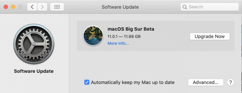

Anybody else's Catalina system, that is not enrolled in the beta program, being offered the latest Big Sur Beta (Release Candidate / GM)? This is also happening on my real MBP that has never been in a beta program.
Edited by Ploddles

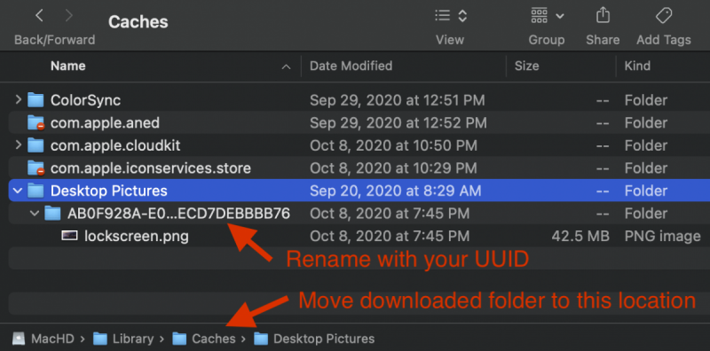

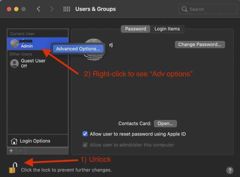

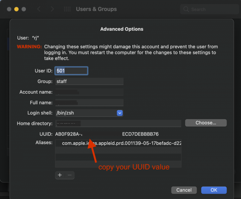

Earlier in this thread, there was some issues with log-in screen being changed after a Big Sur update. This post describes how to fix that issue.
First, a written description and then some images that try to illustrate the words. Attached is a folder containing a Big Sur log-in image; download it and then you must change the UUID to be specific for your system.
Description:
1) Open System Preferences.
2) Select "Users & Groups" --> unlock the padlock --> right click on user --> select 'Advanced' --> copy user UUID from next screen and cancel out of dialog box.
3) Place downloaded folder (Desktop Pictures/UUID/lockscreen.png) into /Library/Caches/
4) Replace folder UUID ("my-UUID") with your UUID copied in step 2.
5) Assign proper writing permission to that folder, using "Get Info", making it Read & Write.
6) After re-booting, you'll now see the BS log-in screen rather than the multi-colored screen (or you can use another image; just re-name as "lock screen.png").
Get your UUID:
1374214784_ScreenShot2020-11-07at8_05_40AM.thumb.png.0bdef173e5bf357d51e329c6bc09e3ac.png
Copy your UUID:
955252823_ScreenShot2020-11-07at8_06_03AM.thumb.png.c557a59305a7332d6da82047f8ade785.png
Place folder and re-name UUID:
1316769107_ScreenShot2020-11-07at8_08_46AM.thumb.png.10acb9128b654f51e5c4e5536b39369f.png
Desktop Pictures.zip
Edited by iGPU
