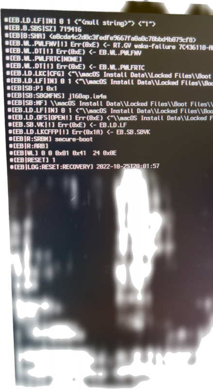

@shrisha both @Jaidy and myself are having problems installing a new version of Ventura on our Gigabyte Xtreme motherboards. I managed to upgrade, my already booting, Monterey but trying to do a fresh install from scratch isn't working. It does the 1st part fine but after rebooting to continue with the 2nd phase our boards just reboot and go straight into a Recovery Console.
If you manage to do a fresh install to another disk, can you post your EFI so I can try it with our Xtreme boards. If that works then I can try and find the differences that are stopping us doing it.

Neither/both of those made any difference. I managed to get a screenshot just before the reboot.
EDIT:
I've just noticed it mentions SecureBoot which I have set as Default. Later on I will try setting it to Disabled to see if that solves my problem.
Edited by Ploddles

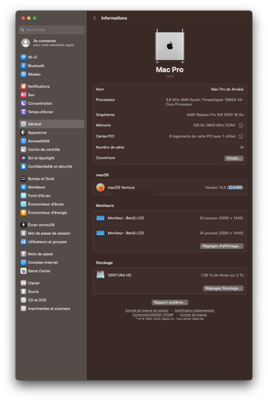

@ Poddles @shrisha @Jaidy As I have a Gigabyte Designare you can compare my current OpenCore 0.8.5 efi Here for Monterey and Ventura.
I just installed Ventura from a USB stick on a blank partition.
Installation successful.
@Fabiosun, you can put in OP this EFI, if you want.

Correction : with the kext AirportItlwm 2.2.0 (Alpha Version) the wifi works but not the bluetooth.
Here is my EFI folder https://mega.nz/file/4Ex31AzR#0j8vTCpKlIsr7MrbzkGX_yfcUtXS2UrejhP00qf6qf8

Yay, I managed to install a couple of fresh copies of Ventura.
1st I had, at some point, inadvertently set Secure Boot in the Config.plist file to Default instead of Disabled.

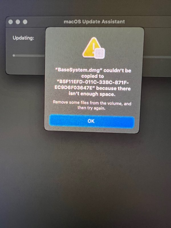

2nd, this enabled me to get to the 2nd part of the install process (see attached) but it kept failing with a message about 'not enough space' even thou it was going to a clean 500GB drive. I tried formatting it as HPFS+ and APFS but I kept getting the same message. The only way I could get passed this message was to reformat the disk with an Apple Partition Map as the Scheme and then reformatting it as a GUID Partition Map AND APFS, not HPFS+
Strange behaviour but it works so I am not complaining.
