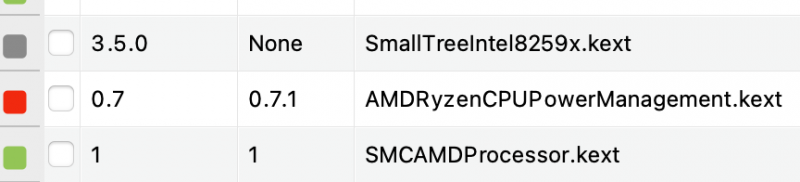

your solid EFi with a minimal effort will be good also with Ventura OS
you have to update this kext to 071 and update also Kernel Patches
Smalltree kext shouldn't work in Ventura (but also in Monterey if I am not wrong)
38 minutes ago, fabiosun said:
@JaidyWelcome Back 🙂
thanks so much @fabiosun I just updated the kext. What kernel patches need to be updated?

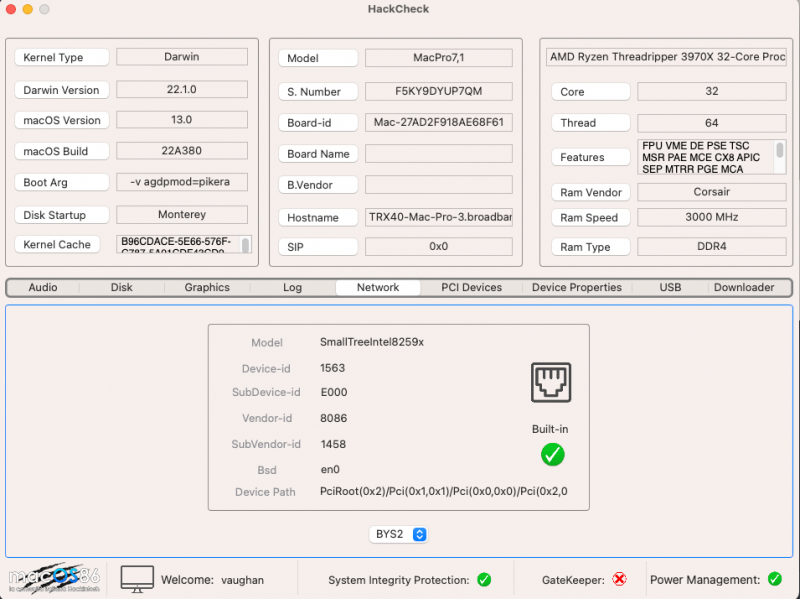

I decided to "bite the bullet" and finally managed to install Ventura RC2 over my Monterey. I can confirm that our network cards do work fine with it.
35 minutes ago, fabiosun said:
@Ploddlesis it an i210 or i211? however great news 🙂
Have you understood which problem have you had before to update?
I am not sure which card it is but I use the SmallTreeIntel8259x.kext. My built in WiFi and Bluetooth card works as well.
Intel® X550-AT2 Dual 10GbE BASE-T LAN with cFosSpeed
and this has yet support (good to know for Aorus Extreme Gigabyte users)
