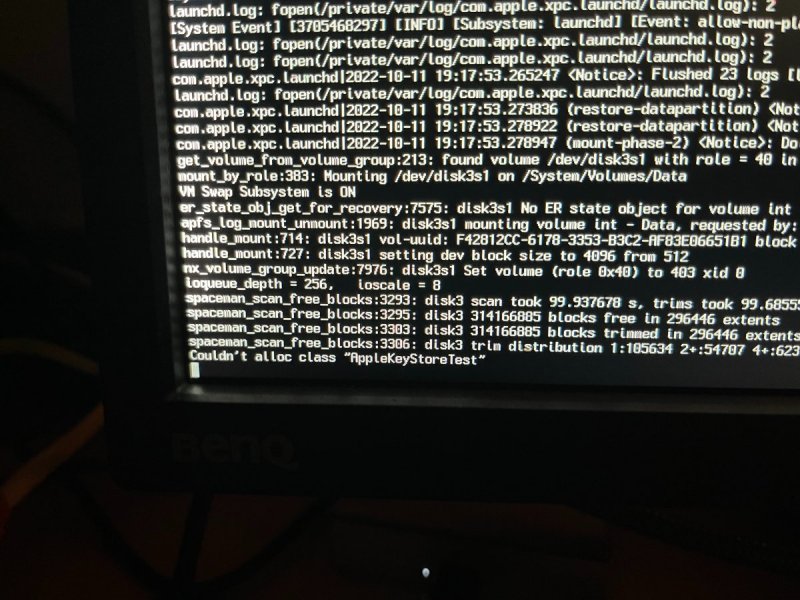

Oof, decided to hop on the beta train with my TRX40 workstation (got a few macs and a few hacs that I jump between). Now I can't get past EXITBS. Before it was booting but stuck on a few steps after ioqueue_depth (something about TRIM). Anyone sitting on pointers?

Here goes;
Monterey, worked great (also updated to 0.8.5 and latest kexts and worked fine) https://www.dropbox.com/s/vonylaw2ykdn76o/EFI Monterey.zip?dl=0
Ventura, stops at "Couldn't alloc class "AppleKeyStoreTest" after  a loooong time https://www.dropbox.com/s/x749invwo9yjgyc/EFI Ventura.zip?dl=0
Edited by 23d1
Added photo of screen.

3 minutes ago, fabiosun said:
ciao @23d1your EFi for Ventura seems pretty fine to me
kexts are updated
your problem could be ethernet card
try to disable its kext or to disconnect only the ethernet cable
