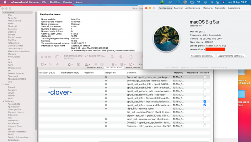

UPDATE 17-07-2021:
16 hours ago, carlo_67 said:
Clover 12 Patch, Opencore, 9 Patch start Bigsur e thanks to Mario 😇
indeed in Clover it does not even serve to enable Quirk
1564600152_Schermata2021-07-12alle19_21_06.thumb.png.9a6bde46162f61b4970c05d035593b98.png
Amarioooooooo 😄
  • Haha 1
  • whahahah 1
1049119044_Schermata2021-07-14alle20_19_24.thumb.png.b90b8fd41f60f5e8234237440458f87f.png
also clover 🙂
but it needs more patches
@Ploddlesit is not a special tool 🙂
it is a quirk and I have talked time ago here
AMD OSX Patches maintainer have done a pull request to add some patches to this quirks all we have in open core available
I have had an opencore debug boot loader with all these patches inserted in it
Only one patch is not public otherwise I
wouldn't be able to boot in Clover Booloader
1178931358_Schermata2021-07-14alle20_34_52.thumb.png.b1e106de0a93a90de5e33a478f5d0753.png
these are patches AMD OSX maintainer would like to insert in a quirk with Shaneee pull request, with these you can bypass a lot of patches enabling that quirk
If opencoredevs accept it would be possible to to reduce the list of visible patches in Kernel/patch section

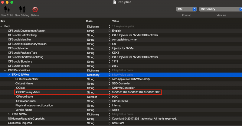

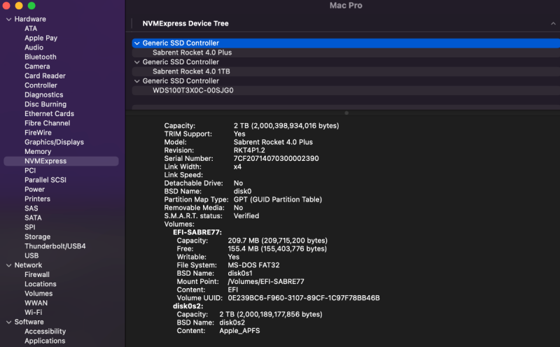

On a different topic (for those of us still stuck with M-ß1 and old patches...:classic_wink:), here is a way to adjust the labelling of the NVMeExpress setting in SystemInfo using a kext file (and then no injection is needed within DeviceProperties).
This kext file was created by apfelnico who posted it here (after his original post here). I've taken liberty in renaming the file (to better describe its function) and adding another section for TRX40 inside the file. You will have to change the settings for your drives; the uploaded file is for my drives and yours are probably different.
[But truly it is not dependent on the mobo, but rather simply on which NVMe drives are in your system as shown below. This means that the "X299" section can be deleted and also means that the "TRX40" section title I made, can be renamed to something else like "NVMeDrives". In fact, this is exactly what I did in the update to the uploaded file: the image of the Info.plist section that says "TRX40" now is "NVMeDrives".]

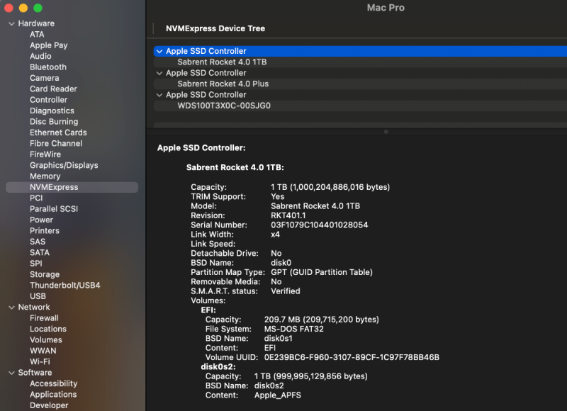

Basically, this kext injects your NVMe drive data so that Apple recognizes it as being an Apple SSD Controller rather than a Generic Controller. This is probably mostly cosmetic, but under the hood, who knows if Apple doesn't treat the controller differently?
Before using the kext (note "Generic SSD Controller" in spoiler):
After using the kext, now "Generic" is changed to "Apple SSD Controller":
How to use NVMeControllerFix

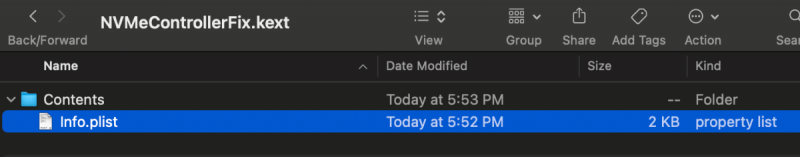

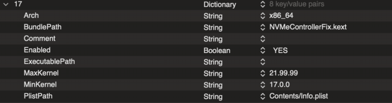

1) To adjust, open the kext and edit the Info.plist file (see Spoiler below):
A) First, open kext by right-clicking on kext and selecting "Show Package Contents":
B) Next, you'll see:
C) Then double-click and open Info.plist in your favorite editor. You'll want to edit the IOPCIPrimaryMatch section. You can even duplicate the TRX40 or X299 section and edit that duplicate, using that section for other mobos that you use.

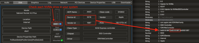

2) After following steps in above Spoiler, you'll want to edit the IOPCIPrimaryMatch section with data collected using HackCheck.
Specifically, using the pop-up shown in the leftmost red box, rotate among your NVMe drives, copying the Device-id and Vendor-id to the IOPCIPrimaryMatch section inside of the Info.plist file. The data is entered as "0x[Device-id][Vendor-id]" (eg, 0x50181987 in the example) with spaces between each NVMe drive in your system.
HackCheck:                                                                                                                                             Info.plist:
3) Save the Info.plist file and add this kext file to your Config/Kernel/Add section.
NVMeControllerFix.kext.zip

thank you @iGPU
it works also in M-ß3 😉
with kext:
560587372_Screenshot2021-07-15at3_56_30PM.thumb.png.6595dfe89c129fede691ed58a11e6f3f.png
without kext:
Nvme in this pictures is on a pciEx card and it is seen by default as Apple SSD Controller
Or Samsung 960 pro is more compatible with apple?
IDK
Edited by fabiosun
with/without kext

I think your Samsung is an SSD drive, the others are NVMe. This kext is only needed for NVMe drives.
3 hours ago, fabiosun said:
no @iGPUit is a 960 pro 1Tb MVME
Mounted on a pciex card as you can see in this bad picture :
I doubt it's a Samsung benefit, but probably related to pciEx card connection. The obvious way to test, is to exchange the Samsung with one of the Sabrent NVMe.
But I wouldn't bother: too much work. I'd just use kext for the internal NVMe drives.

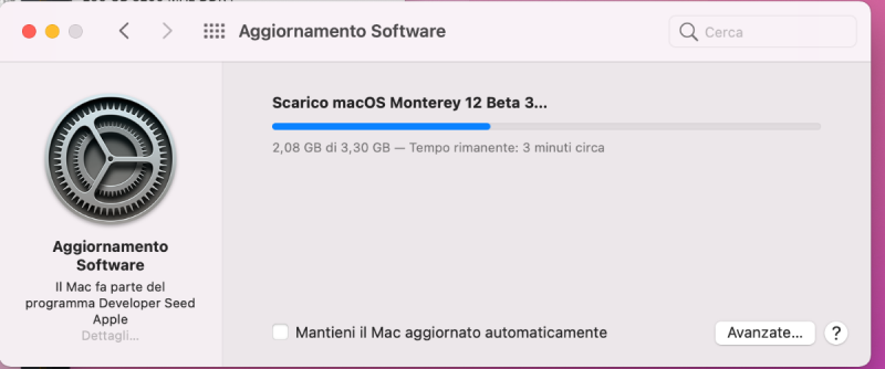

hey guys....maybe you have missed something... 😛
b2/b3 patch has been published....
only read me is old....
secret was revealed by Shaneee a day ago or more 🙂 🙂
the secret is gone 🙂 🙂 🙂
