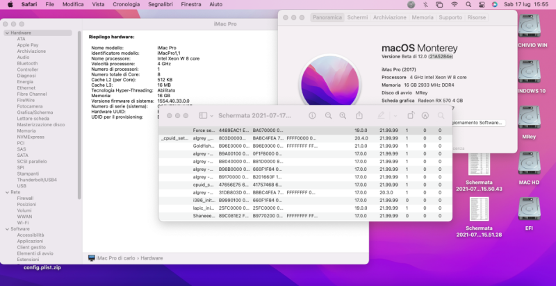

2 minutes ago, carlo_67 said:
I'm there too, minimal Patch, Bigsur / monterey these are my Quirks
Wifi intel Working and Ethernet, unfortunately no BT,

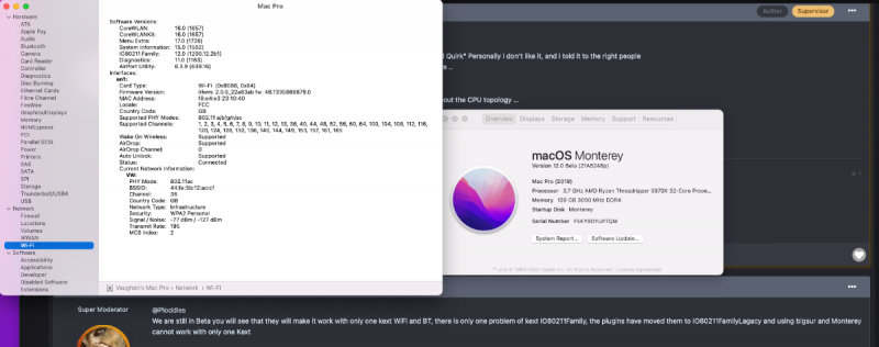

@Ploddles
We are still in Beta you will see that they will make it work with only one kext WiFi and BT, there is only one problem of kext IO80211Family, the plugins have moved them to IO80211FamilyLagacy and using bigsur and Monterey cannot work with only one Kext

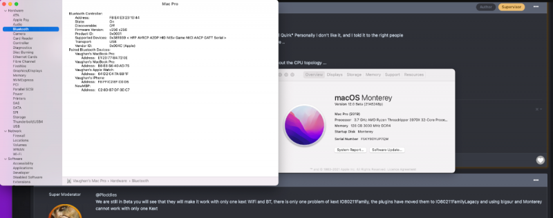

12 minutes ago, carlo_67 said:
@Ploddles
This has been the case since at least Mojave, both kexts are needed.
They both work in Monterey and Big Sur.

maybe we could refine also this patch:
algrey - _cpuid_set_info - GenuineIntel to AuthenticAMD - 10.13/10.14/10.15/11.0/12.0
maybe on this MaxKernel should be 20.99.99
it seems not mandatory for  Monterey B3
Still no final installation.

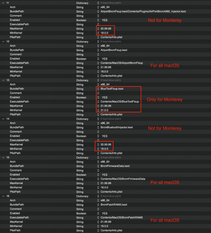

For WiFi/BT in Big Sur and Monterey, look at following image. Note: this is only for Fenzi-type AIC or swapped internal cards, not the stock, internal AX200. WIth a mac-compatible card, these kexts will allow AirDrop to work. See this post of details. To use the kexts shown below, you also must inactivate the internal AX200. I have discussed this many times (see here and here). If you do not inactivate the internal AX200, your BT will not properly work.
On the other hand, if you use the stock AX200, entirely different kexts are required (which I won't discuss here), and in that situation, you must not use any of the kexts in the below image. I refer to the special AX200 kexts in the above first referenced post, providing a link to their source. Furthermore, understand that if you use the internal AX200, while you'll have WiFi and BT with those other kext files, AirDrop will not work: trade-offs.
Edited by iGPU
