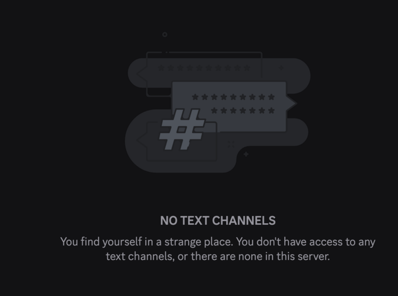

https://discord.com/channels/249992304503291905/1027560607030984766/1358074891730944032
Thank you, fabiosun.  Do I understand right that problems with video and system stability do not depend on the DSDT? Who could advise what to do with my EFI, What's wrong there are
