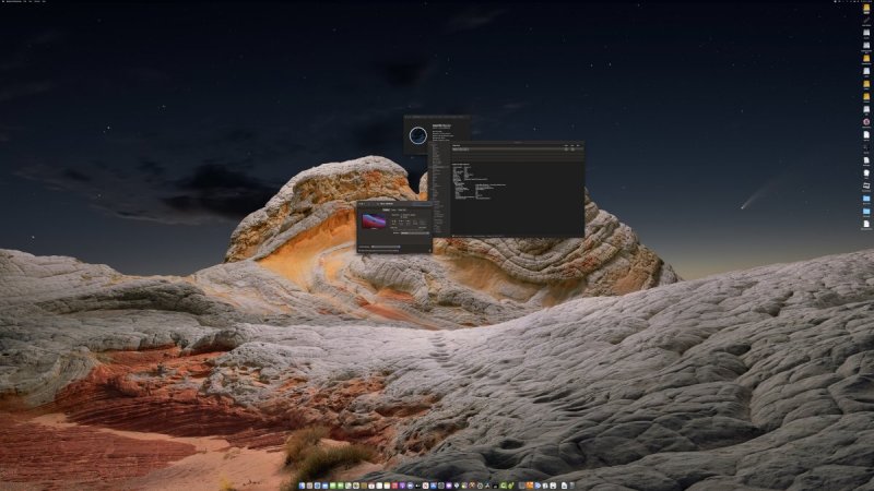

Driftwood Posted December 4, 2020 Share Posted December 4, 2020 7 minutes ago, shutterbug168 said: Is that the Dell 8K monitor? I thought macOS wouldn't support it in true 8K... You are the man👍 Yeah but you have to scale. Here's what its like in 8K (good for Photo/video editing though!) 1 Link to comment Share on other sites More sharing options...
shutterbug168 Posted December 4, 2020 Share Posted December 4, 2020 2 minutes ago, Driftwood said: Yeah but you have to scale. Here's what its like in 8K (good for Photo/video editing though!) Very cool🤣 I almost bought it but changed my mind after reading some comments about macOS sensing the dual display port output as TWO 4K monitors🤨 Also, love your minimalist EFI -- not even the SSDT-EC-USBX.aml needed. Did you replace the m.2 wifi/BT card or using a PCIe fenvi card with the same Broadcom chip? On my Asrock X299 Creator mobo, I have to use the PCIe card because swapping out the M.2 card caused boot problem (that was before PC 063). Thanks again! Link to comment Share on other sites More sharing options...

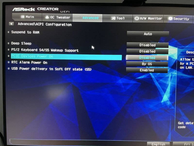

Rox67er Posted December 4, 2020 Share Posted December 4, 2020 @shutterbug168 The BIOS setting for wake on lan is here: It is called PCIE Devices Power On but in the help text it shows this is also for Wake on Lan. 16 hours ago, Driftwood said: Big Sur Sleep Video Catalina Sleep Working @Rox67er & other Asrock board owners: My Asrock Creator EFI for both BS & Cat (with two variants of config (ie one with full Algrey patches called 'config1.plist', the other 'Config2.plist' with the only patches we need thanks to *fabiosun testing) - please update and enter with your own platform info and rename your chosen configs.plist to config.plist). * Please note I swapped out the motherboard's wifi/BT for a Broadcom 100% Apple supported version board. However, I dont much use wifi/BT so test away! Driftwood Cat BS with 2 variant configs EFI.zip 1.83 MB · 8 downloads I copied your EFI and used the limited patch list, replaced my info. All is well, system boots fine but still no sleep, it wakes up immediately after sleep. It must be somewhere in the BIOS settings. Could you save your config file to usb and share it? 1 Link to comment Share on other sites More sharing options...

shutterbug168 Posted December 5, 2020 Share Posted December 5, 2020 8 hours ago, Rox67er said: Love to hear if it works for you, I still don't get sleep to work. 🥵 @Rox67er, thanks for sharing the link and PCIe power option -- I have set to disabled... but still not shutting down properly. I plan to install @Driftwood's EFI tomorrow. Until I try the EFI, I always have CSM set to "enabled" in order to boot up my AMD hack. Is it the same in your case? Will report back tomorrow... Link to comment Share on other sites More sharing options...

Rox67er Posted December 5, 2020 Share Posted December 5, 2020 14 hours ago, shutterbug168 said: @Rox67er, thanks for sharing the link and PCIe power option -- I have set to disabled... but still not shutting down properly. I plan to install @Driftwood's EFI tomorrow. Until I try the EFI, I always have CSM set to "enabled" in order to boot up my AMD hack. Is it the same in your case? Will report back tomorrow... CSM disabled, Above 4G enabled. Link to comment Share on other sites More sharing options...
shutterbug168 Posted December 5, 2020 Share Posted December 5, 2020 52 minutes ago, Rox67er said: CSM disabled, Above 4G enabled. So, I swapped out the intel wifi/bt m.2 card and installed @Driftwood's EFI this morning... Both wifi and BT work accordingly! Unfortunately, I have no luck with both sleep and shutdown🤨 The only thing I added to the EFI was Opencanopy because I do have a separate Windows 10 nvme drive. When I do shutdown, the worst part is that the hack will immediately restart and get stuck at code "99" on the mobo (DXE_SIO_INIT -- IO initialization problem?). I will have to turn the power off completely in order to get the machine rebooting properly... 11 hours ago, fabiosun said: @shutterbug168 for shutdown problem: have you defined properly your mmio whitelist in your config.plist? could you post your debug log file thank you @fabiosunWhere's the log file located? Thanks! Link to comment Share on other sites More sharing options...
