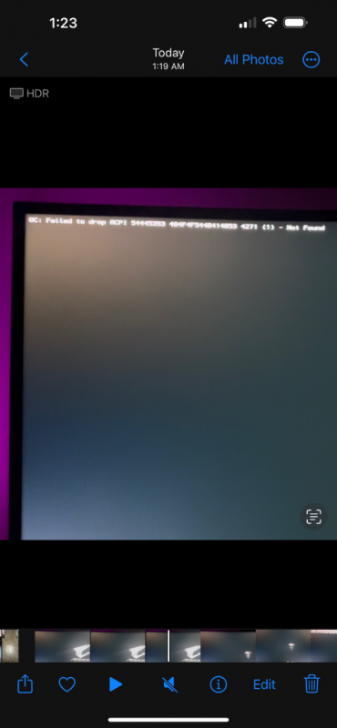

Supervisor fabiosun Posted December 20, 2022 Author Supervisor Share Posted December 20, 2022 3 minutes ago, Jaidy said: Hello everyone, I am getting a message ACPI error something that appears for a very brief moment before the open core boot menu. Can someone please look at my EFI and help me get rid of that? https://drive.google.com/drive/folders/1qOZkB0Bj0q8348JIikpD5u4QyOw9a8MA?usp=share_link Could you post a photo of acpi error you see ? thanks Link to comment Share on other sites More sharing options...
Jaidy Posted December 21, 2022 Share Posted December 21, 2022 It says OC: Failed to drop ACP 54445353 484F4F5ffB41B414B53 4271 (1) - Not Found Link to comment Share on other sites More sharing options...
Supervisor fabiosun Posted December 21, 2022 Author Supervisor Share Posted December 21, 2022 1 hour ago, Jaidy said: It says OC: Failed to drop ACP 54445353 484F4F5ffB41B414B53 4271 (1) - Not Found could you try this config and see if it is the same or not? config.plist.zip Link to comment Share on other sites More sharing options...
Jaidy Posted December 22, 2022 Share Posted December 22, 2022 17 hours ago, fabiosun said: could you try this config and see if it is the same or not? config.plist.zip 6.3 kB · 2 downloads worked like a charm to eliminate the said error. Thanks a ton. There's another error though (not due to using this config, already existed since I upgraded to Ventura) that the onboard wifi works on and off. I have the alpha kext Airportlwm v2.2.0 from around 2 weeks back. Any suggestions for that? 🙂 Link to comment Share on other sites More sharing options...

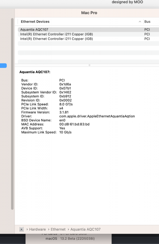

valmeida Posted January 10, 2023 Share Posted January 10, 2023 Happy New Year everyone . I'm back from my holiday and I'm catching up with all the posts . I see that Aquantia 107 cards are working . I will give it a shot tonite. I there anything special kext I need to load or patch? Link to comment Share on other sites More sharing options...

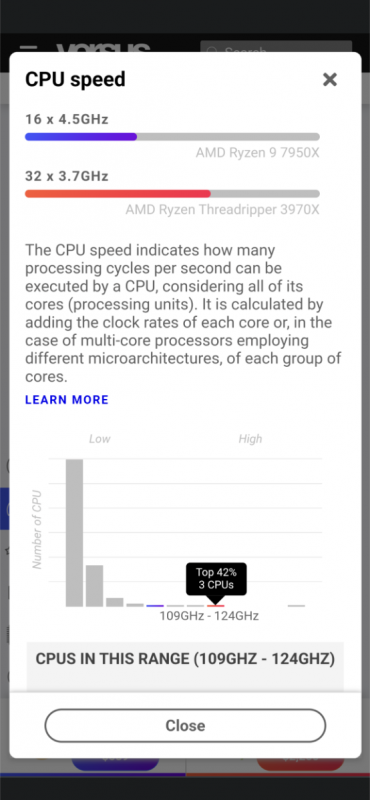

Driftwood Posted February 7, 2023 Share Posted February 7, 2023 (edited) Its a great performer (AMD 9 7950x) but with 32 cores, the TRX40 3970x still wins! Out of interest @fabiosun how much did you sell your 3970x for? Edited February 7, 2023 by Driftwood 1 Link to comment Share on other sites More sharing options...

Supervisor fabiosun Posted February 9, 2023 Author Supervisor Share Posted February 9, 2023 On 2/7/2023 at 1:04 PM, Driftwood said: Its a great performer (AMD 9 7950x) but with 32 cores, the TRX40 3970x still wins! True in multi core tasks in daily usage, like editing with davinci resolve or many tasks with after effects or photoshop it is faster about 20% compared to 3970x On 2/7/2023 at 1:04 PM, Driftwood said: Out of interest @fabiosun how much did you sell your 3970x for? I bought with that money my system and I have about 1000€ more in my pocket but I did only because I didn’t change my system from too much time as last consideration I am happy of this system as I was in the past with trx40 one 🥹 1 Link to comment Share on other sites More sharing options...

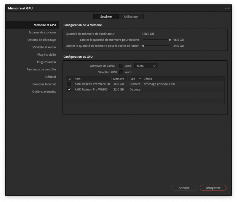

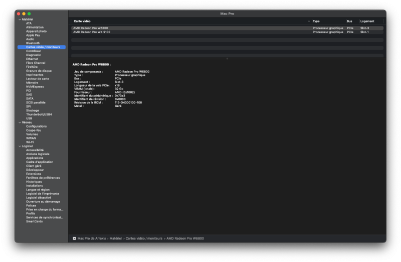

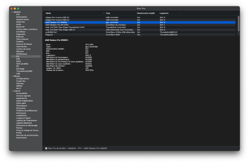

Arrakis Posted February 9, 2023 Share Posted February 9, 2023 Hello, I bought an AMD Radeon Pro W6800. AMD It is natively recognized by OSX. Spoiler My first idea was to part with my two Amd Radeon Pro WX9100. But I noticed that the card heats up very quickly at 100° with peaks at 105° when the gpu is used at 100% with Resolve for example. I understand better why there has never been a blower model on the 6000 series when Gigabyte had planned a RX6900XT blower version when this series of this type of GPU was announced. And I also realize that Apple is only adding the X on these versions. The temperatures are also identical on their models. YouTube Morgonaut So I chose to install it on slot 3. Installation note: If the card is installed as the main GPU on slot 1 with the monitors connected to it. I have to deactivate the WhatereverGreen kext otherwise it's the black screen before the opening of the session. If the card is installed on slot 3 with the screens connected to a WX9100 in slot 1. I can keep the WhatereverGreen kext. This is my current setup. Which allows me to use it as a pure GPU for all the software from which you can choose your working GPU, for example like this: Spoiler 1 Link to comment Share on other sites More sharing options...

Supervisor fabiosun Posted February 9, 2023 Author Supervisor Share Posted February 9, 2023 1 hour ago, Arrakis said: If the card is installed as the main GPU on slot 1 with the monitors connected to it. I have to deactivate the WhatereverGreen kext otherwise it's the black screen before the opening of the session. in this condition it should work adding pikera bootarg (we have same behaviour with 6900 xt 1 Link to comment Share on other sites More sharing options...
