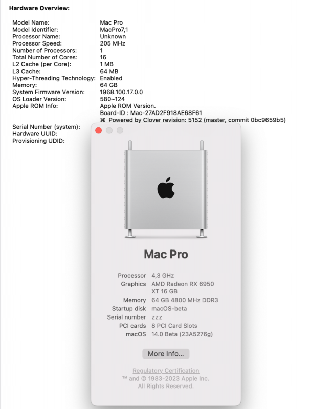

@Ploddles thanks for telling me. I’d wait for it to get working before I try on my machine. It’s my work machine anyway, so I would want it to be stable…
@fabiosun right. I use a USB adapter anyway, but it’d be good to get the onboard one to work too for Apple’s techs that use WiFi
I am using it as my main disk now (I have also a more solid Ventura 13.5 b2 backup, just in case)
it is stable and the only problem I have is the lack of wifi (and all things connected to this (airdrop, continuity cam)
but happy for this beta (not many differences compared to previous Os)
@Ploddleshave you updated your kext to latest kexts commit (beta)?
or have you used the usual bootarg useful for beta (-lilubetaall)?
@fabiosun @Jaidy It is now installed and working.😀 The updated patch by CaseySJ (re 10 bit tags) fixed the problem and the patch works for both Ventura and Sonoma.
It seems to be working OK, apart from WiFI and Bluetooth. Hopefully updated WiFi and Bluetooth kexts will be available in the next few weeks. It is installed on a separate NVMe drive so I can dual boot macOS. I haven't installed many Apps yet so can't report on their compatibility.

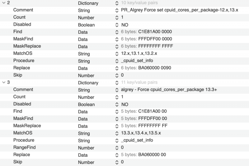

Here is my Config.plist (OC 0.9.3), it works perfectly for Ventura 13.3 and higher.
This means that if you have a system lower than 13.3, you must add the patch: algrey - Force cpuid_cores_per_package 12.0 or even algrey - Force cpuid_cores_per_package 10.15, 11.0.
For Sonoma you will also need to add the new patch from: CaseySJ - probeBusGated Disable 10 bit tags - 12.0/13.0/14.0

Rather than list them all, see the ones in my config, attached, ie they all change except the one to boot Ventura pre-13.3 if you still boot that at all. If you are at Ventura 13.3 or above then you can delete the pre 13.4 patch.
config.plist.zip
