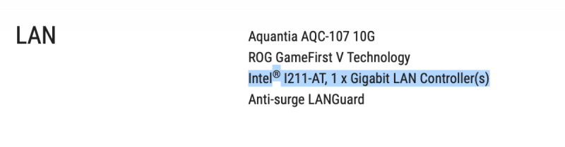

Your ethernet card is not supported for now in OSX greater than Big Sur
If you are using it this is the problem you have
you can solve for now in different way
Disabling ethernet from bios
Disconnect ethernet cable
put e1000=0 as bootarg to disable OSX driverkit
I can't say more without knowing your EFI configuration

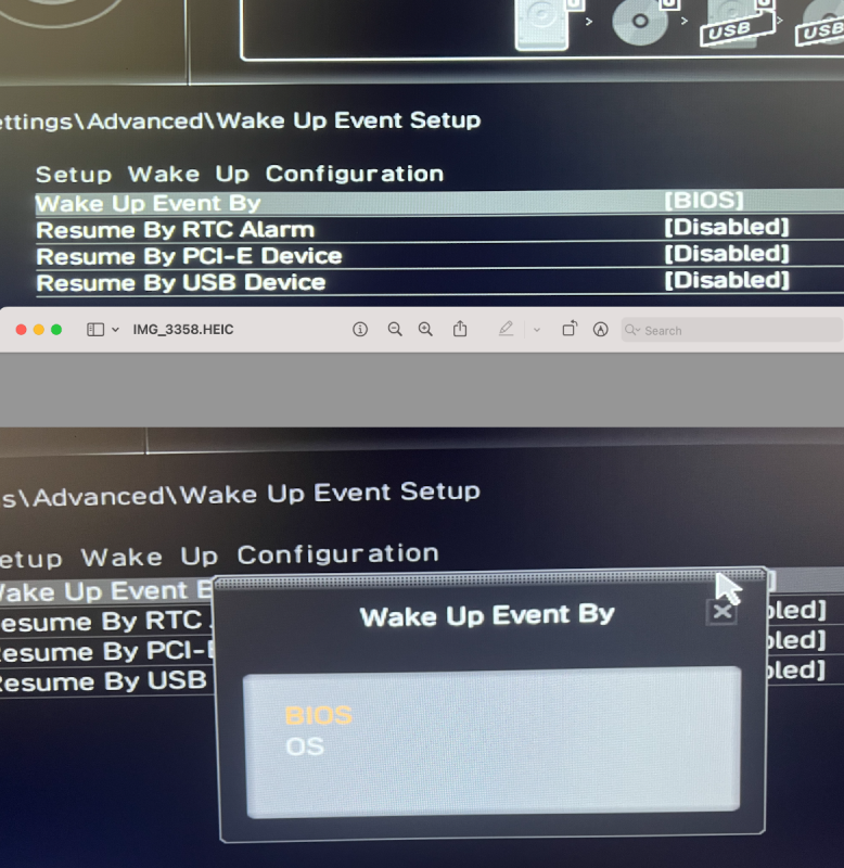

21 minutes ago, Arrakis said:
Do you have an idea ?
could you try to disable Wake on USB in your bios and see if it is the same?
I'm trying to have Erp Enable functional not causing the reboot after shutdown.
in my rig if I use Wake on usb bios function I have the same
EDIT_
added pictures
also using OS happens!
OS has no those three options as Bios has
And resume By Usb if I am on BIOS option for wake up event produces the problem
