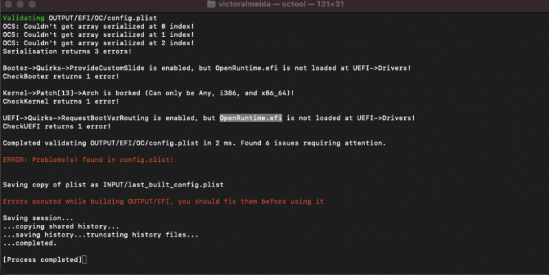

I just discovered if I update my OC by validating with  ProperTree and trying to commit by config.plist by doing an OC snapshot it won't boot. I want to compare my config.plist before the snapshot and after. Can someone guide me? I would like to update OC to  .78
I tried to use OC_tool to see what is going on I got the error below
Hi @valmeida
your EFI had some problems
this attached should be corrected you had also an error on Aquantia definition
I do not know if it solves your problem
I suggest to learn this simple app to update OC:
https://github.com/ic005k/OCAuxiliaryTools
EFI-078 valmeida.zip

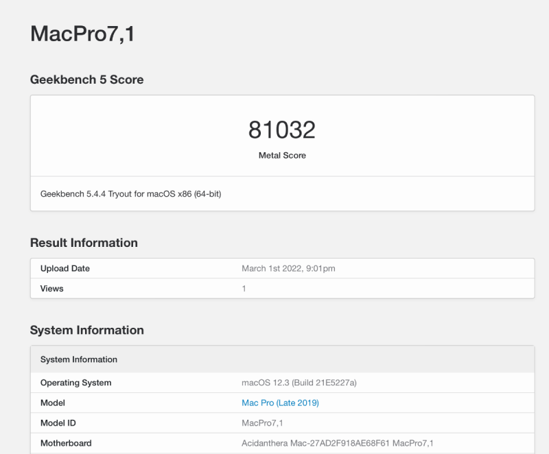

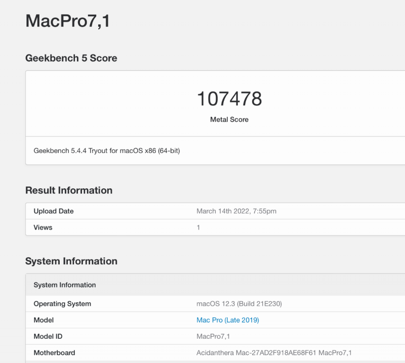

5 hours ago, fabiosun said:

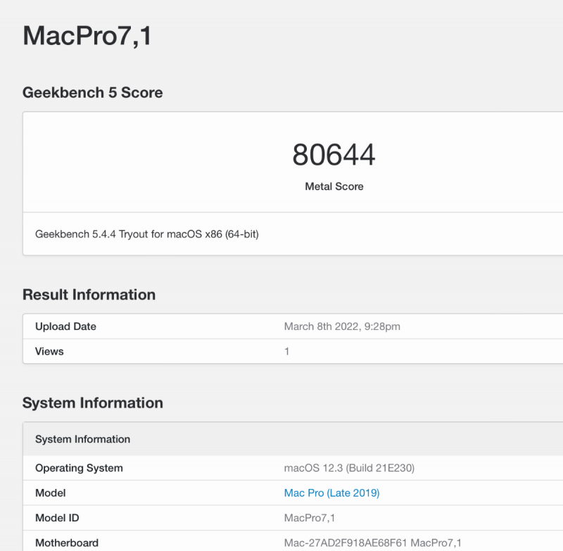

Monterey 12.3 is OUT
DO NOT INSTALL! 😞
All problems are there as latest its beta!
197111453_Screenshot2022-03-14at7_35_13PM.thumb.png.8dca7aa27385e9b239f8293d74c08866.png
see glitch, ethernet problems ad Metal performances
191730915_Screenshot2022-03-14at7_56_29PM.thumb.png.f053f7293d65652bf68280777ea1a3f7.png
before about 200000

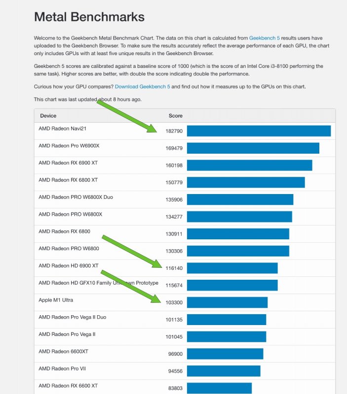

Damn. Starting to wonder if the changes introduced are tied to some deeper system or kernel updates... Perhaps a new major obstacle to overcome for the community at large... Has anyone tested on Apple hardware to compare? Don't have a 2019 Mac Pro handy anymore, just MacBook Pro's.
in this version of OSX it would appear that Apple has leveled metal performance towards its new top-of-the-range ARM platform
I can also feel good and the benchmarks in my opinion are not of much use, but I can't fully understand the obvious problems that even professional applications with Monterey 12.3 have
Is it possible that Apple has completely wrong an operating system or rather such an important update of a "main release"?
I can't understand how it is possible to use this system with the lag and the impressive lack of performance with software like Davinci Resolve for example
Am I missing something?
Edited by fabiosun

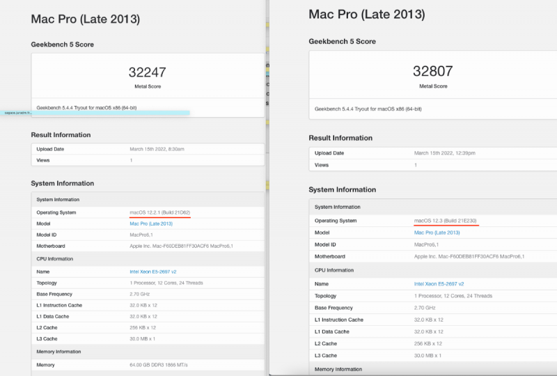

I'm hoping this is rectified as the updates are rolled out as 12.3.1 and upwards, because if it's an issue on genuine Apple machines, that's a catastrophe for people like myself using GPU render software for 3D and so forth.
I just upgraded from Monterey 12.2.1 to Monterey 12.3.0 on my 2013 Mac Pro and the Metal performance of one of the two D700 cards is identical except for a few values.
I will test later on my Hack with my Radeon Pro WX 9100 cards to determine if this is a problem that only affects 6000 series cards.1973487991_Capturedecran2022-03-15a12_52_42.thumb.png.b6ee4342452b35aa9761699b322888de.png

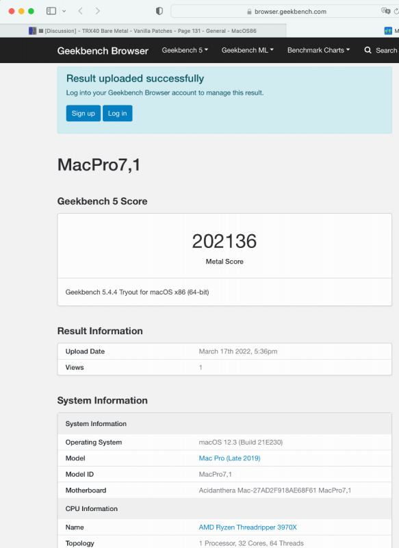

On 3/17/2022 at 9:24 AM, fabiosun said:
Thank you @antunedduto point me in a right direction and some users of others forum (IM and TM 🙂 )
attached a plist which solves performance problem with 6xxx GPU series in Monterey 12.3
Change your GPU address and string info if you like a correct name for your GPU
344623532_Screenshot2022-03-17at5_36_35PM.png.da20568bbb42e2c03c3a79f27cd01f5b.thumb.png.6ec89007cc77a1ea63c517f6b8905750.png
This works for all 6000 series?

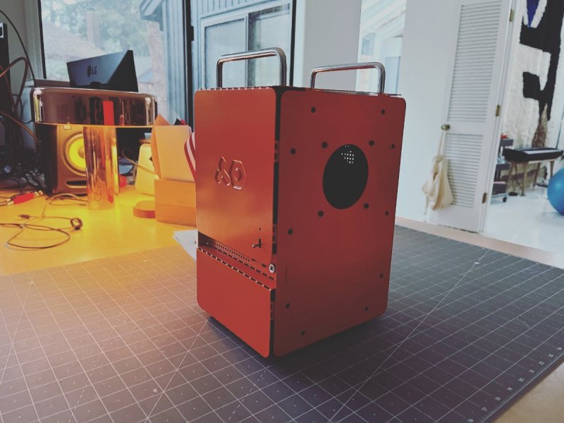

Thanks for this! My recent compact build with 6600XT seems to be working without the additional plist entry, but the workstation with 6800XT had issues when I tried the betas.
Another issue I'm running into is that 12.3 doesn't support Bluetooth via Intel AX200 anymore, it seems. Which was working fine in 12.2.1... I have various WiFi modules lying around, so might hold off on updating the workstation and just add in a Broadcom module into the compact build... But it's not as fast as WiFi6 or 6e....
Attached a shot of the compact build.
Teenage Engineering Computer-1 Chassis
Gigabyte B550 Aorus Pro AX
AMD Ryzen 9 5950x
64 GB Corsair Vengeance 3200mhz
2TB Sabrent 4.0 Plus
1TB Sabrent 4.0
Faster than the 24-core Xeon Mac Pro... Amazing.
