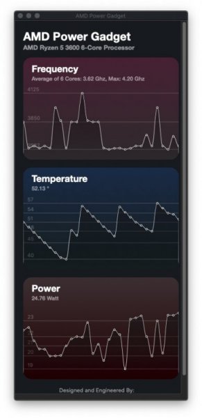

yurkins Posted February 26, 2020 Share Posted February 26, 2020 @ iCanaro on my 3950x it won't display graph for frequency. I installed the latest 0.2 version of SMCAMDProcessor and the AMD Power Gadget works but frequency graph is missing. Needs other settings in Opencore? Thanks! Link to comment Share on other sites More sharing options...
yurkins Posted February 26, 2020 Share Posted February 26, 2020 Also VirtualSMC and SMCSuperIO are latest v.1.1.1 Link to comment Share on other sites More sharing options...
Support Team iCanaro Posted February 27, 2020 Author Support Team Share Posted February 27, 2020 0.2.1 trulyspinach Fixes temperature sensor value offset on Zen 1 processors. Add support for macOS 10.13 Fixes a problem that cause AMD Power Gadget to crash on system with 32 or more than 32 cores. 2 Link to comment Share on other sites More sharing options...

yurkins Posted February 28, 2020 Share Posted February 28, 2020 On 2/26/2020 at 4:47 PM, yurkins said: @ iCanaro on my 3950x it won't display graph for frequency . I installed the latest 0.2 version of SMCAMDProcessor and the AMD Power Gadget works but frequency graph is missing. Needs other settings in Opencore? Thanks! Fixed 🙂 https://github.com/trulyspinach/SMCAMDProcessor/issues/4#issuecomment-592460963 2 Link to comment Share on other sites More sharing options...

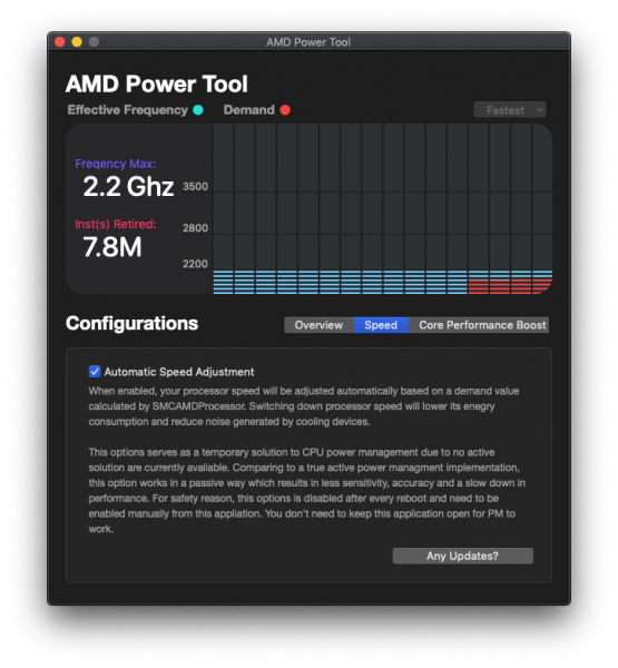

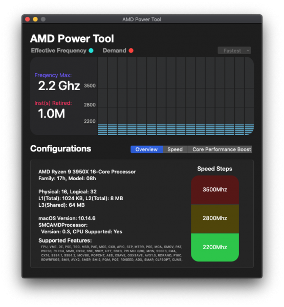

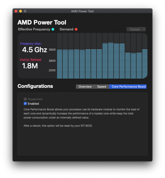

Support Team iCanaro Posted March 9, 2020 Author Support Team Share Posted March 9, 2020 AMD Power Tool trulyspinach This new release contains important changes. Please read carefully before you proceed. KEXT Started a new versioning system. Performance Optimization CPU frequency data is no longer read from MSR:0xC0010293. A more accuracy algorithm from effective frequency is used instead. Added support for reading PStateDef created by EFI BIOS. Added support for setting processor PState. Added support for controlling Core Performance Boost. Added support for passive power management. AMD Power Tool New module in AMD Power Gadget featuring basic configurations of AMD Processor. Please refer to README for more details before you start using AMD Power Tool. AMD Power Gadget Redesigned menu bar items. Known issues GraphView might not display as rounded corner on older version of macOS Some sensor data will not show up in iStat depending on SMBios type. Refer to #10 Instructions retired might not includes instructions from hyper threaded cores. This is due to some bug in underlying dependences. 2 Link to comment Share on other sites More sharing options...
Support Team iCanaro Posted March 9, 2020 Author Support Team Share Posted March 9, 2020 il Tool è spaziale!!! Mettendo il flag ad automatic speed adjustement al volo il sistema cambia in una forma di risparmio energetico togliendo il flag tutto ritorna immediatamente come prima Link to comment Share on other sites More sharing options...
Support Team iCanaro Posted March 13, 2020 Author Support Team Share Posted March 13, 2020 0.3.1 trulyspinach KEXT Effective frequency calculated now have better accuracy(+/- 50MHz). Added support for writing PStateDef. AMD Power Tool PState Editor is now available. Known issues GraphView might not display as rounded corner on older version of macOS Some sensor data will not show up in iStat depending on SMBios type. Refer to #10 Instructions retired might not includes instructions from hyper threaded cores. This is due to some bug in underlying dependences. System might panic when invalid PState are provided during apply. Link to comment Share on other sites More sharing options...
