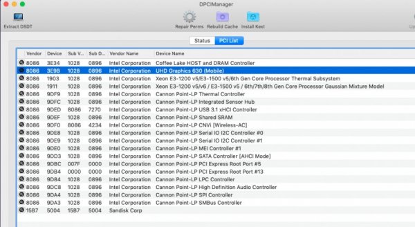

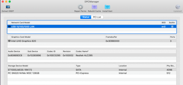

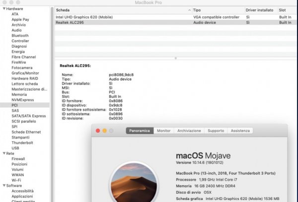

Support Team iCanaro Posted October 29, 2019 Author Support Team Share Posted October 29, 2019 (edited) @Gengik84 oggi ho l'oggettino tra le mani, aggiornato kexts, clover, driver e mojave ultima release da ioreg ti pare tutto a posto?! DELL_2_1.ioreg.zip origin 2.zip Edited October 29, 2019 by iCanaro Link to comment Share on other sites More sharing options...
Support Team iCanaro Posted October 29, 2019 Author Support Team Share Posted October 29, 2019 mancava anche l'ultimo security update.. :Thumbs_Up_Sign_Emoj fatto!!! Link to comment Share on other sites More sharing options...
Administrators Gengik84 Posted October 30, 2019 Administrators Share Posted October 30, 2019 @iCanaro :Thumbs_Up_Sign_Emoj :;-D: Link to comment Share on other sites More sharing options...
