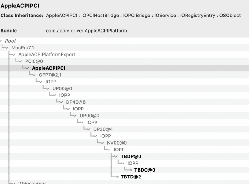

backinblackx86 Posted January 5, 2025 Share Posted January 5, 2025 @fabiosun does the x870e proart support USB4 under MacOS? Link to comment Share on other sites More sharing options...
Supervisor fabiosun Posted January 5, 2025 Author Supervisor Share Posted January 5, 2025 41 minutes ago, backinblackx86 said: @fabiosun does the x870e proart support USB4 under MacOS? No they are asmedia usb4 and they only work to charge iphone for now (and forever i think) Link to comment Share on other sites More sharing options...
backinblackx86 Posted January 5, 2025 Share Posted January 5, 2025 9 minutes ago, fabiosun said: No they are asmedia usb4 and they only work to charge iphone for now (and forever i think) On my x670e system, the USB-C TB ports do have USB functionality but not TB. Link to comment Share on other sites More sharing options...
Supervisor fabiosun Posted January 6, 2025 Author Supervisor Share Posted January 6, 2025 10 hours ago, backinblackx86 said: On my x670e system, the USB-C TB ports do have USB functionality but not TB. Weird on my x670e hero tb4 was maple ridge chip and all was working . Only hot plug wasnt Link to comment Share on other sites More sharing options...
Supervisor fabiosun Posted January 6, 2025 Author Supervisor Share Posted January 6, 2025 @backinblackx86 check here: Link to comment Share on other sites More sharing options...
backinblackx86 Posted January 7, 2025 Share Posted January 7, 2025 19 hours ago, fabiosun said: Weird on my x670e hero tb4 was maple ridge chip and all was working . Only hot plug wasnt could the TB4 need to be mapped? Link to comment Share on other sites More sharing options...
Supervisor fabiosun Posted January 7, 2025 Author Supervisor Share Posted January 7, 2025 No Sorry maybe are you also on discord and you are searching for others confirmations😀 Link to comment Share on other sites More sharing options...
