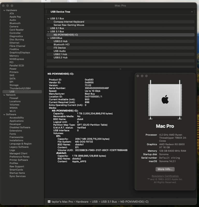

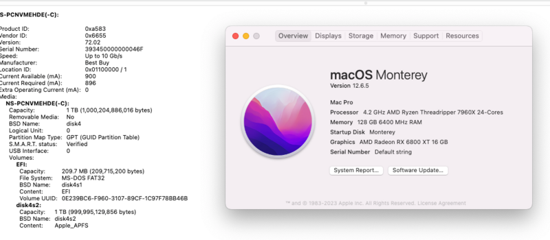

Somewhat of a dual purpose test: I pulled an NVME disk from my AM4 setup that contains vanilla installations of Monterey, Sonoma, and Ventura. I connected the drive to the rear USB-4/TB port with a USB-C NVME enclosure rated for 10 Gbps, purchased at my local Best Buy (https://www.bestbuy.com/site/insignia-m-2-nvme-to-usb-c-ssd-enclosure/6500317.p?skuId=6500317) The OpenCore Boot picker (loaded from the EFI on my SATA SSD) showed the NVME drive's installations as "external" options and booted right into Ventura without fault. While technically not a TB device, it did work! Next I will give Sonoma and Monterey a go...as well as the older CBR15...stand by
Edited by backinblackx86
Well that all worked out...as proof of my post above, booting from usb4 ports with an external NVME worked well. Much to my surprise the system booted both my Monterey installation, something my AM4 system will not boot, as well as Sonoma. Attached are screenshots of system profiler alongside the About this Mac window.
