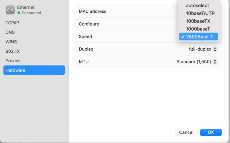

18 minutes ago, fabiosun said:
try to set manually hardware speed
that appears to have done the trick...I will test the stability with iperf3 if it is available on the cli.
Appears to be stable, at least at 1000baseT, my 10GbE equipment is in another area.
