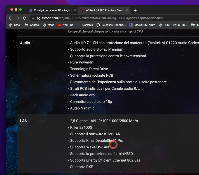

se puo' essere d'aiuto....questo quanto ho reperito al momento in rete:
"as it turns out, contrary to my Googling, the E3100G is not based on an Intel chipset at all. It’s actually a Realtek chipset! You’ll need the LucyRTL8125Ethernet kext to make it work, and you may need to set the speed manually if it’s not on a 2.5gbps link (I had this problem as it’s connected to a 1gbps network port)"
provare non costa nulla
aggiungilo e poi settalo manualmente da recovery come ti dicono

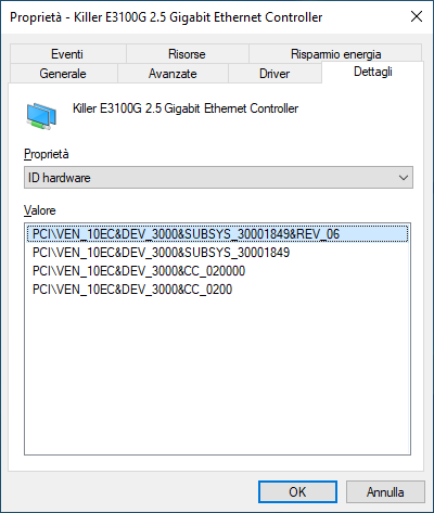

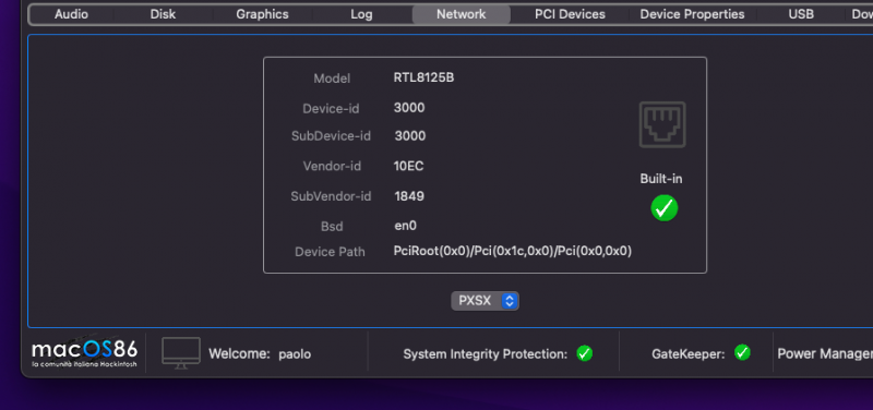

Nella efi che ho mandato io ha già kext rtl8125, ma la killer 3100g ha dev id pci8086, 3100 e rtl8125 nel plist ha questi dev id
<string>LucyRTL8125</string>
            <key>IOPCIMatch</key>
            <string>0x812510ec 0x81251186 0x300010ec</string>
