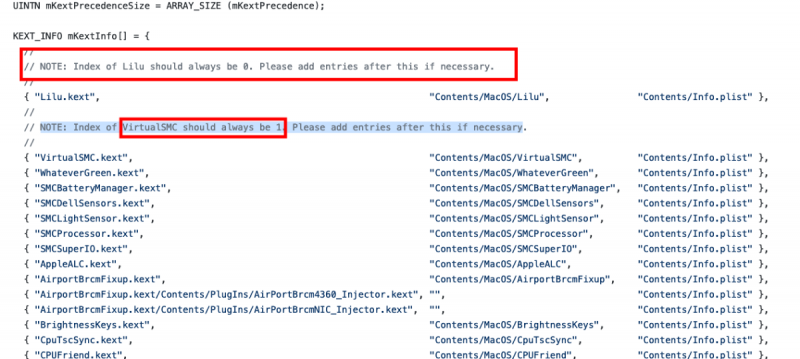

Administrators Gengik84 Posted March 6, 2021 Administrators Share Posted March 6, 2021 Il 3/3/2021 at 21:29, dreamwhite ha scritto: 2. Perchè non viene rispettato l'ordine di caricamento delle kext come scritto chiaramente nel codice sorgente di ocvalidate? (source) Quello non è l'ordine obbligatorio di come devono essere inseriti e definiti i kext sul config... non c'entra nulla... lol  1 1 Link to comment Share on other sites More sharing options...
A23SS4NDRO Posted March 6, 2021 Share Posted March 6, 2021 8 minutes ago, Gengik84 said: non c'entra nulla.. diciamo che i commenti un po' lo suggeriscono:   Però ho sentito opinioni differenti.. riporto alcune citazioni:  1) Kext load order is determined based on dependency. First, all dependencies and CFBundleIdentifiers for all kexts to load are gathered and all parents within the Kexts folder are determined, then the list of kexts is walked - skipping and readding to the end of the list any child kext whose parent has not been added yet. This is repeated until all kexts have been added. As for the ExecutablePath not being filled in - injector kexts are plist-only. They have no executable, and as such, that field will be blank. The executable is determined based on the contents of the Info.plist of the kext, and verified before attempting to walk the list of kexts. This is neither an issue with your config or the software, and appears to be working as intended.  2) Kext load order is specific - but only when comparing kexts that are dependent on each other. Lilu being first isn't a requirement - it just needs to load before any of its plugins. AppleALC and WhateverGreen are not dependent on each other, and as such, it doesn't matter which of them is first - but Lilu must be loaded before either of them as they both depend on it.  3) Both OC Snapshot and the Clean snapshot also verify kext load order based on dependency checking and warn if you attempt to load kexts with duplicate bundle ids that overlap when comparing min/max kernel - [...] (Propertree) also ensures kext load order based on dependency checking, and will prompt if they're ordered incorrectly. Kext load order is verified on every snapshot, clean or otherwise.  4) [...] (Propertree) also verifies kext load order - ensuring that all parents are loaded before children - and if the existing order is incorrect, it'll prompt you with an offer to fix it when snapshotting     Link to comment Share on other sites More sharing options...

A23SS4NDRO Posted March 6, 2021 Share Posted March 6, 2021 8 minutes ago, Gengik84 said: non c'entra nulla.. diciamo che i commenti un po' lo suggeriscono:   Però ho sentito opinioni differenti.. riporto alcune citazioni:  1) Kext load order is determined based on dependency. First, all dependencies and CFBundleIdentifiers for all kexts to load are gathered and all parents within the Kexts folder are determined, then the list of kexts is walked - skipping and readding to the end of the list any child kext whose parent has not been added yet. This is repeated until all kexts have been added. As for the ExecutablePath not being filled in - injector kexts are plist-only. They have no executable, and as such, that field will be blank. The executable is determined based on the contents of the Info.plist of the kext, and verified before attempting to walk the list of kexts. This is neither an issue with your config or the software, and appears to be working as intended.  2) Kext load order is specific - but only when comparing kexts that are dependent on each other. Lilu being first isn't a requirement - it just needs to load before any of its plugins. AppleALC and WhateverGreen are not dependent on each other, and as such, it doesn't matter which of them is first - but Lilu must be loaded before either of them as they both depend on it.  3) Both OC Snapshot and the Clean snapshot also verify kext load order based on dependency checking and warn if you attempt to load kexts with duplicate bundle ids that overlap when comparing min/max kernel - [...] (Propertree) also ensures kext load order based on dependency checking, and will prompt if they're ordered incorrectly. Kext load order is verified on every snapshot, clean or otherwise.  4) [...] (Propertree) also verifies kext load order - ensuring that all parents are loaded before children - and if the existing order is incorrect, it'll prompt you with an offer to fix it when snapshotting     1 Link to comment Share on other sites More sharing options...
Administrators Gengik84 Posted March 6, 2021 Administrators Share Posted March 6, 2021 non è l'ordine dei kext sul config. io posso mettere per esempio: Lilu VirtualSMC AppleALC WEG  e va benissimo non è che è errato perchè sul codice di ocvalidate trovate WEG prima di AppleALC 1 Link to comment Share on other sites More sharing options...

Administrators Gengik84 Posted March 6, 2021 Administrators Share Posted March 6, 2021 Quello che conta è lilu primo poi è ovvio che il kext "madre" deve essere prima dell'eventuali plugins Link to comment Share on other sites More sharing options...
A23SS4NDRO Posted March 6, 2021 Share Posted March 6, 2021 1 minute ago, Gengik84 said: trovate WEG prima di AppleALC si ma non sono dipendenti tra loro quindi non cambia... Link to comment Share on other sites More sharing options...

A23SS4NDRO Posted March 6, 2021 Share Posted March 6, 2021 1 minute ago, Gengik84 said: Quello che conta è lilu primo Dipende, infatti come avevo citato prima: 3 minutes ago, A23SS4NDRO said: Lilu being first isn't a requirement - it just needs to load before any of its plugins.  La regola generale de facto è "i plugin vanno dopo" Link to comment Share on other sites More sharing options...
Administrators Gengik84 Posted March 6, 2021 Administrators Share Posted March 6, 2021 1 minuto fa, A23SS4NDRO ha scritto: si ma non sono dipendenti tra loro quindi non cambia... eh appunto.. Altrimenti si fa passare un obbligo di dichiarazione facendo di tutta l'erba un fascio ma non è così di fatto non è il codice di ocvalidate da seguire alla lettera Adesso, A23SS4NDRO ha scritto: La regola generale de facto è "i plugin vanno dopo" ecco si esatto, questo è quello che conta, ma alla fine l'ordine, se rispetti questo discorso che dici, è indifferente con ordine intendo generale dei kext dichiarati sul config conta "madre" e poi plugins Link to comment Share on other sites More sharing options...
Administrators Gengik84 Posted March 6, 2021 Administrators Share Posted March 6, 2021 poi calcola che il codice è anche stato giustamente scritto in alfabeto per molti versi, anche per renderlo migliore e decisamente più ordinato Link to comment Share on other sites More sharing options...

A23SS4NDRO Posted March 6, 2021 Share Posted March 6, 2021 22 minutes ago, Gengik84 said: Quello che conta è lilu primo in realtà se mettessi prima qualcosa del tipo prima FakeSMC e poi Lilu non sarebbe errato, addirittura lo stesso vale se metti prima RealtekRTL8111" e poi Lilu 1 minute ago, Gengik84 said: ma intendevo che puoi in caso vedere e verificare cosa può aver fatto di errato si certo ma a questo punto conviene direttamente andare a mano piuttosto che aprire un configurator e poi andare a vedere dove eventualmente ha fatto ehm.. "stupidaggini" 1 Link to comment Share on other sites More sharing options...
Administrators Gengik84 Posted March 6, 2021 Administrators Share Posted March 6, 2021 beh teoricamente anche si il fatto è proprio come si diceva prima ossia la "madre" e poi il resto quindi considerando che Lilu è la base... del resto basta che sia appunto messo prima dei suoi derivati nel tuo esempio sia FakeSMC che RTL8111 non sono "figli" di lilu quindi potrebbero stare dichiarati prima..giusto Link to comment Share on other sites More sharing options...
