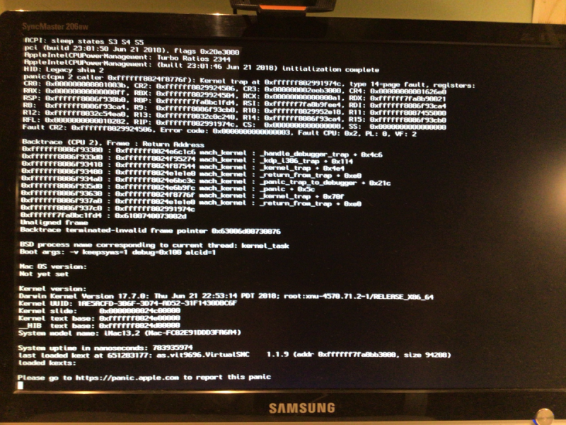

Miky066 Posted January 23, 2021 Share Posted January 23, 2021 (edited) Ciao a tutti, sono rimasto bloccato qui, come posso risolvere? Edited January 24, 2021 by Miky066 Aggiunta di altre immagini Link to comment Share on other sites More sharing options...

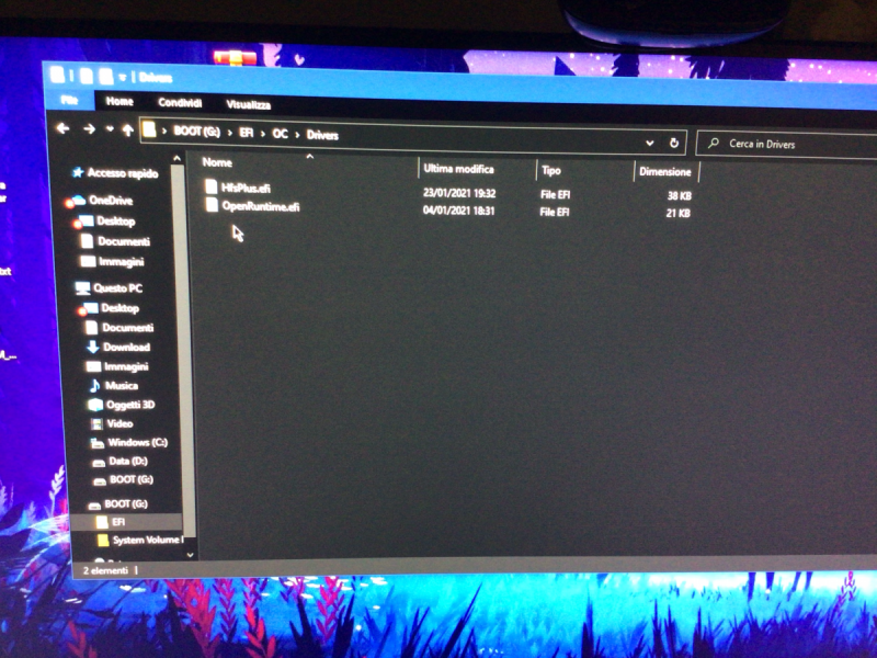

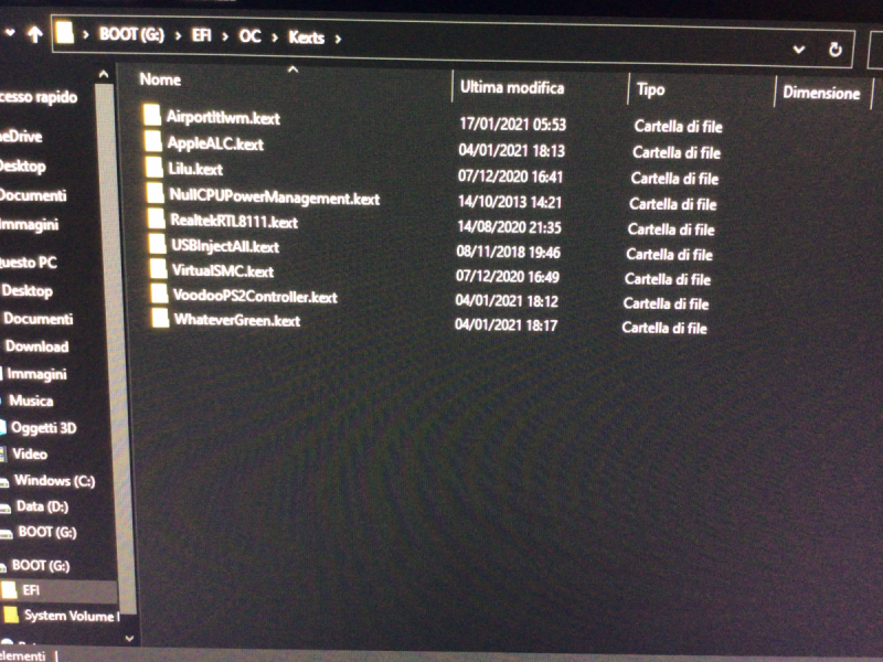

Miky066 Posted January 24, 2021 Author Share Posted January 24, 2021 (edited) Allora, io ho utilizzato opencore e ho seguito una guida, il mio pc ha le seguenti caratteristiche: -CPU: Intel Core i7 3770K (Ivy Bridge) -Scheda Madre: Asus P8Z77-V LE PLUS -Scheda Grafica: NVIDIA Quadro 2000 Ora allego i miei kext, drivers e acpi sul post PS: sto creando la chiavetta d’installazione con catalina Edited January 24, 2021 by Miky066 Link to comment Share on other sites More sharing options...

Miky066 Posted January 26, 2021 Author Share Posted January 26, 2021 (edited) Allora allego la mia cartella EFI (se potete controllarla e sistemarla)EFI.rar Edited January 26, 2021 by Miky066 Link to comment Share on other sites More sharing options...

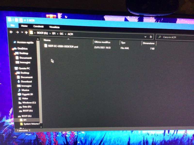

Support Team iCanaro Posted January 26, 2021 Support Team Share Posted January 26, 2021 cambia è architettura Fermi https://www.techpowerup.com/gpu-specs/quadro-2000.c900 ma non la vedo contemplata tra quelle supportate per la EFI non è malaccio, vedi qui per la sezione ivy bridge per correzioni https://dortania.github.io/Getting-Started-With-ACPI/ssdt-methods/ssdt-prebuilt.html#desktop-sandy-and-ivy-bridge Link to comment Share on other sites More sharing options...
Miky066 Posted January 26, 2021 Author Share Posted January 26, 2021 (edited) Ok, quindi pensi possa tenerla o no? (Intendo la scheda grafica) in quanto all’EFI, devo sostituire il file che si trova nell’ACPI con quei 2 file della sezione Prebuilt giusto? (Il pc è un desktop, non il laptop) Edited January 26, 2021 by Miky066 Link to comment Share on other sites More sharing options...
Miky066 Posted January 26, 2021 Author Share Posted January 26, 2021 Alla fine di tutto, per quello che ho capito, faccio così. Invece di mettere il file di installazione di Catalina, metto quello di High Sierra, la efi la lascio invariata e sostituisco i file nell’ACPI, giusto? Link to comment Share on other sites More sharing options...
Support Team iCanaro Posted January 26, 2021 Support Team Share Posted January 26, 2021 puoi anche installare high sierra, ma sempre SSDT-EC-DESKTP + magari SSDT-IMEI devi avere Link to comment Share on other sites More sharing options...

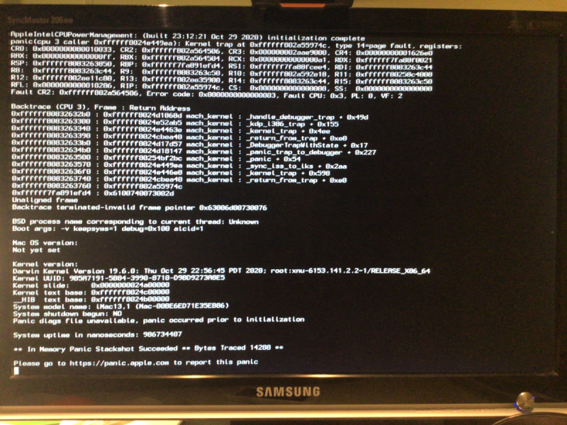

Miky066 Posted January 26, 2021 Author Share Posted January 26, 2021 (edited) Ok mi è uscito questo (ho già resettato la NVRAM), sará un problema di VirtualSMC? Edited January 26, 2021 by Miky066 Link to comment Share on other sites More sharing options...
Support Team iCanaro Posted January 26, 2021 Support Team Share Posted January 26, 2021 @Miky066 sostituisci EFI e prova EFI_IvyBridge_Clover5129_.zip Link to comment Share on other sites More sharing options...
