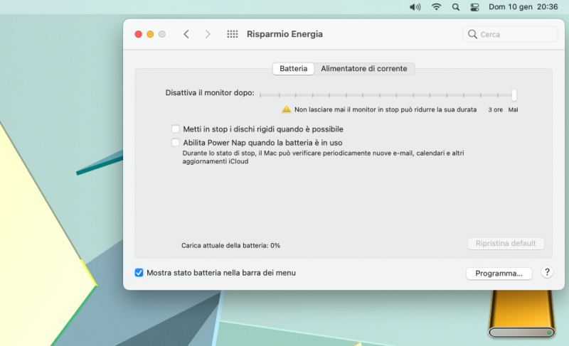

marco.pisellonio80 Posted January 10, 2021 Share Posted January 10, 2021 Continua a non andare. La batteria non compare proprio. Intanto però ho preso la EFI di bubbleg5 e ho sostituito DSDT e config. Ora ho la versione 0.6.5? Link to comment Share on other sites More sharing options...
Administrators Gengik84 Posted January 10, 2021 Administrators Share Posted January 10, 2021 l'hai ricollegata? sei su BS? in caso devi mettere la spunta su mostra percentuale 1 Link to comment Share on other sites More sharing options...
marco.pisellonio80 Posted January 10, 2021 Share Posted January 10, 2021 Sì, sono su Big sur. Ho messo la spunta, ma non esce proprio l'iconcina della batteria. Link to comment Share on other sites More sharing options...
Administrators Gengik84 Posted January 10, 2021 Administrators Share Posted January 10, 2021 Riprova DSDT.aml.zip 1 Link to comment Share on other sites More sharing options...
marco.pisellonio80 Posted January 10, 2021 Share Posted January 10, 2021 Niente da fare 🙁 Link to comment Share on other sites More sharing options...
