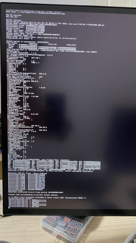

Hello everyone I have a question . I have a forum member  that has same identical  hardware expect for the CPU I have a 3970x  and he has a 3960x. For some reason when trying to boot I get this kernel panic. Do I have to make a change in the EFI for his CPU.
No

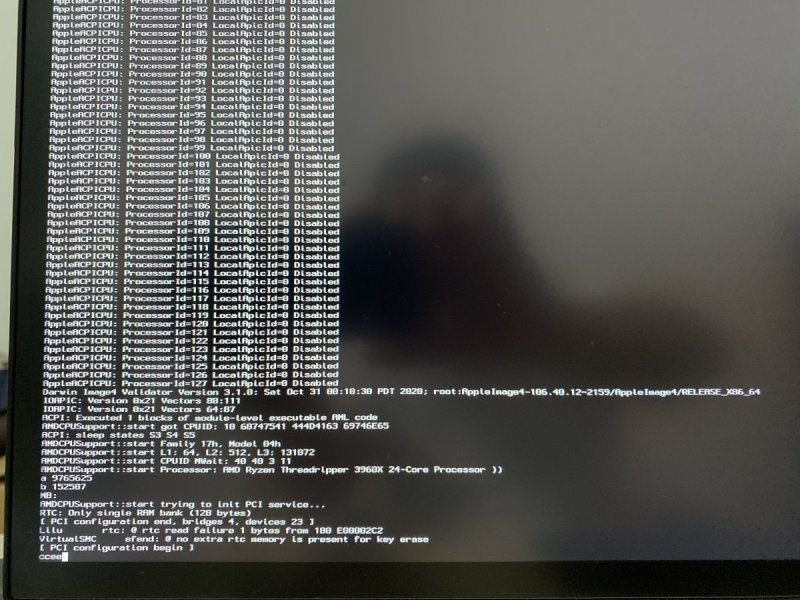

@fabiosun @valmeida I somehow, re-applied the patches.plist from AMD-OSX, and it was recognized the correct CPU, and it keep booting longer, to this section and automatically restart the system, any ideas?
PS: My EFI same as @valmeida uploaded, just re-applied the pacthes.plist

@cleverhome
if your system never booted in OS X post here if you want in exact order this stuff:
1) your bios version and all configuration settings
2) use an OpenCore debug version to have your exact MMIO list
3) DO NOT use as is other user EFI
after this, we have to simplify a bit your EFI to start, then, when it will boot, you can add all you need
As I have said to @valmeidawhen I helped him with his rig, your motherboard in my opinion is the best one available...
So it works and maybe better of others...

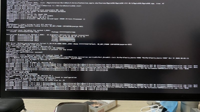

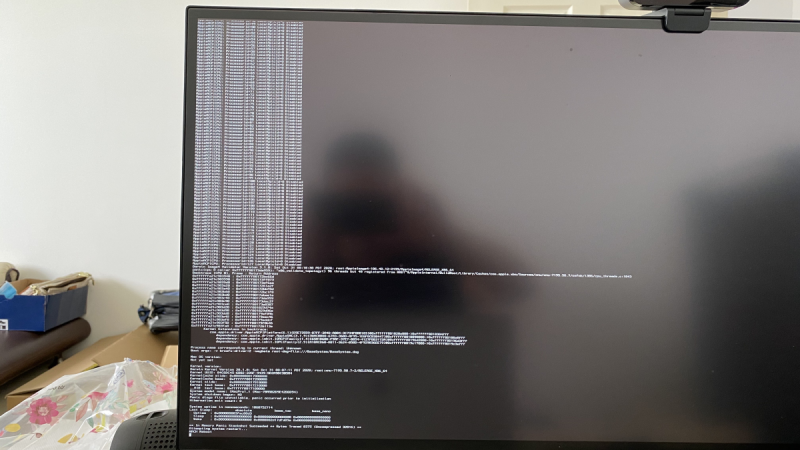

Thank you @fabiosun
It's stuck here, please see the attachment, also including Log file, please help
opencore-2020-11-19-022523.txt.zip

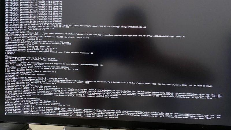

@fabiosun
It still get stuck, I attach the screenshot and Log file.
It seem happen as the first time, hanging for a while and loading something damn quickly then automatically restart.
The BIOS setting was kept the same, since you said it's good setting (I saved a profile, I reload the  profile every before trying to boot).
Awaiting for your further investigating.
opencore-2020-11-19-195413.txt.zip

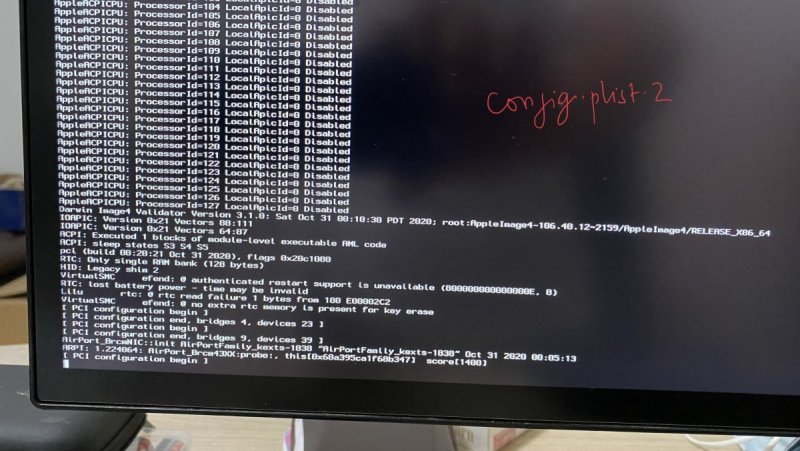

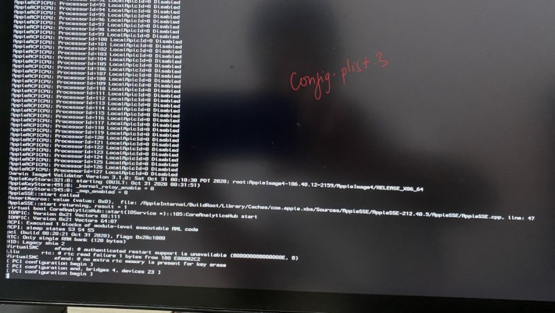

25 minutes ago, fabiosun said:
ok try latest EFi I have put above
change completely the previous one (backup it )
below two configs are for opencore EFI
I have nulled AMD Power tools kext for now
try with Opencore EFI
config.plist 3.zip 6.56 kB · 0 downloads config.plist 2.zip 6.69 kB · 0 downloads

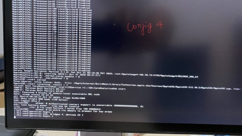

2 screenshots with config 2 & config 3
23 minutes ago, fabiosun said:
this is last thing to try by now..with opencore)
I have no others ideas to try for now...
sorry
