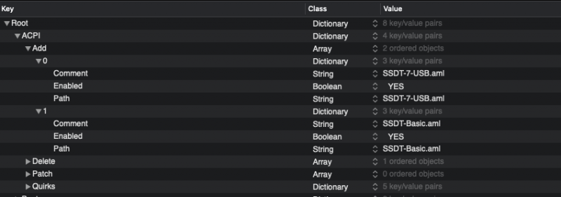

Administrators Gengik84 Posted November 16, 2020 Administrators Share Posted November 16, 2020 fai questa prova, scarica in download SSDT-Basic, aggiungilo e dichiaralo sul config rimuovi il resto di ssdt tranne SSDT-7-USB Link to comment Share on other sites More sharing options...
xXGiulioXx Posted November 17, 2020 Author Share Posted November 17, 2020 20 hours ago, Gengik84 said: fai questa prova, scarica in download SSDT-Basic, aggiungilo e dichiaralo sul config rimuovi il resto di ssdt tranne SSDT-7-USB ho trovato SSDT- Basic e l'ho inserito e poi ho tolto tutti gli altri ssdt tranne ssdt-7-USB ma non sono riuscito a dichiararlo nel config. Allego la efi con i file giusti ma con il config da perfezionare EFI.zip Link to comment Share on other sites More sharing options...
Administrators Gengik84 Posted November 17, 2020 Administrators Share Posted November 17, 2020 modifica così Link to comment Share on other sites More sharing options...
xXGiulioXx Posted November 17, 2020 Author Share Posted November 17, 2020 7 minutes ago, Gengik84 said: modifica così provo, ma che applicazione è? Link to comment Share on other sites More sharing options...
Administrators Gengik84 Posted November 17, 2020 Administrators Share Posted November 17, 2020 plist editor 2 Link to comment Share on other sites More sharing options...
xXGiulioXx Posted November 17, 2020 Author Share Posted November 17, 2020 On 11/16/2020 at 8:48 PM, Gengik84 said: fai questa prova, scarica in download SSDT-Basic, aggiungilo e dichiaralo sul config rimuovi il resto di ssdt tranne SSDT-7-USB 7 hours ago, Gengik84 said: modifica così Ci hai preso come al solito @Gengik84, sono finalmente riuscito ad aggiornarea Big Sur! Grazie mille dell'aiuto 1 Link to comment Share on other sites More sharing options...
