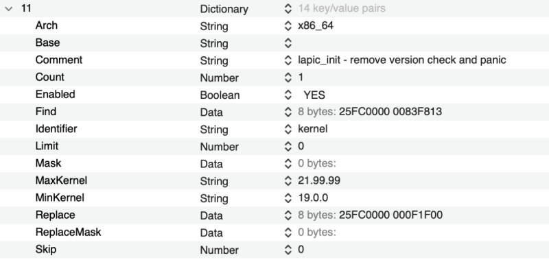

I have not had your patch 11 enabled in my config.plist for many many months now. Have you tried without it?
This must be enabled for me to boot in 11.5 beta.
On 6/26/2021 at 7:05 PM, fabiosun said:
to be more clear , without that patch my system does not boot
it boots fine with this one (NoOne official one and it seems completely different from one I and @Ploddlesand maybe other people are using):
478913803_Screenshot2021-06-26at7_03_14PM.thumb.png.37ca8fac631a9f08a3ef5ef06c40d23c.png
It would be useful to understand why 🙂

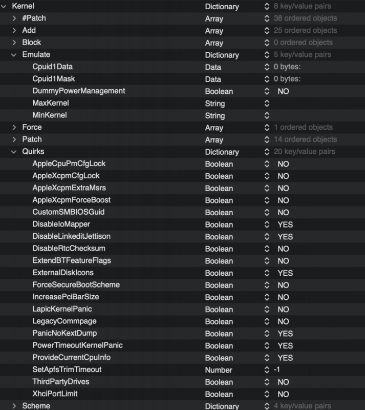

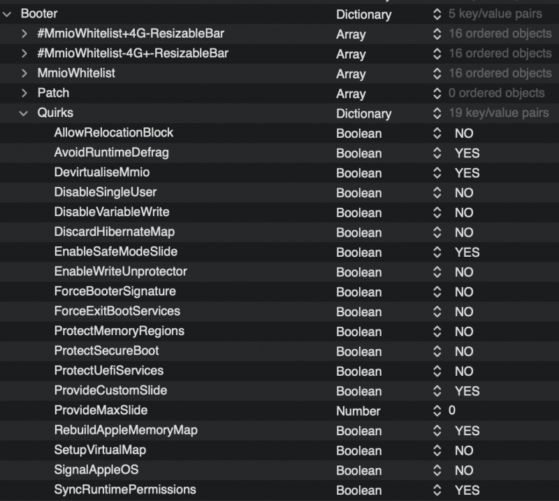

Shown are the settings used for Quirks in OC with the minimal Patch list presented earlier. As for BIOS, both Above 4G and ResizableBar are disabled.

pay attention to the kext you have in use with your EFI

@iGPUI do not use RebuildAppleMemoryMap and DisableIOMapper in my config
I have 4G enabled

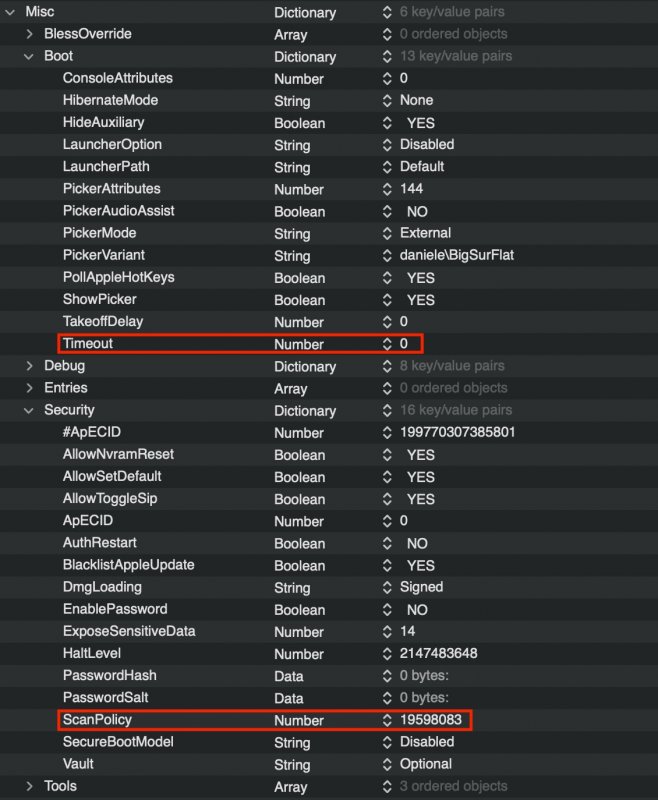

1 hour ago, Jaidy said:
I tried updating to the latest beta 4, but it somehow is stuck. Boots back to the beta 3 for me. Hopefully you would have better luck..
As Ploddles was alluding, the timer may be going too fast. Change Timeout to 0 and there will be no auto-boot until you select the drive and press Enter.
Also, use the ScanPolicy value below to ensure that all devices are properly seen in the menu for selection.
