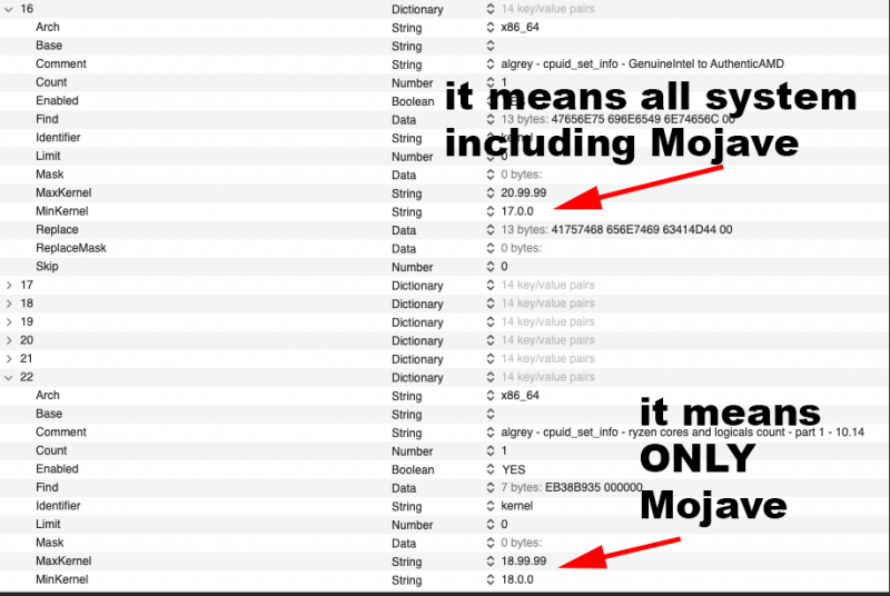

I'm trying to install Mojave on my ryzentosh but installation process doesn't start....of course it dependes from missing kernel patches for Mojave. I search in github and there is a list of patches....but i'm as a newbie with AMD hacks so could someone help me to find the correct patches to use with Mojave?
dear mine 🙂 😛
full set of patches attached...
patches.plist.zip
