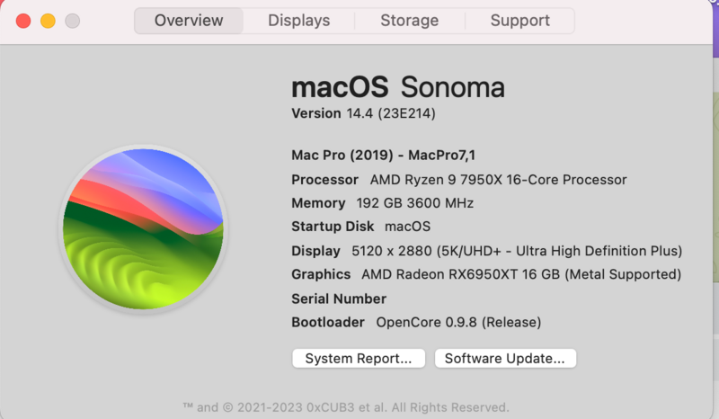

Unable to update from sonoma 14.3 to 14.4. The installer launches but after the first reboot, the installation is stopped and starts on the current system.
I tried with an installation key. The result is the same.
Here is my config under OpenCore 0.9.8.
Here

00:261 00:003 OC: Loading Apple Secure Boot with Disable (level 1)
00:264 00:003 OC: Failed to find SB model Disable
Go back to your original config and disable the Bluetooth and Wireless kexts. The update should then run fine. After it has finished you can re-enable the Bluetooth and Wireless kexts. If you are using the Intel wifi kext make sure you use the "AirportItlwm-Sonoma14.4-v2.3.0-DEBUG-alpha-ef2e076" or newer version - it has to be the one comparable with Sonoma 14.4.

Your procedure worked. I enabled all kexts and ACPI Thunderbolt and Secure boot enabled again in the config.plist
I was careful, I did a clean install and migrated my old system. Like this I have both systems 14.3 and 14.4.
