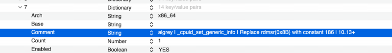

2 hours ago, fabiosun said:
these 2 patches why?
It was added for laptops to prevent panic during CPU enumeration. it's i think not needed on desktop
but doesn't hurt keeping it as it removes the TSC check.
i prefer to leave simple as i can and those patches are not useful for AM4/5 and trx40 platforms
also this:
not useful..and no one explain why it is there or in which condition could be useful 😉
maybe you know
also this:
maybe you know
In this patch, we are just replacing the whatever value that gets stored in that register with a fix value so that it always follow a certain path in the code. This mostly prevents panic.
copy that, the question is different IMHO
When this panic could happen without this patch?

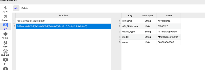

@fabiosun @Ploddles can you please look at my EFI...
Edited by Jaidy
@Jaidyit seems only one kext you have is outdated (blutoothfixup)
i would try to update it and if system have the same problem after this i would try to disable ethernet kext as AppleIGB (and verify if this kext is good for your ethernet card)
also i see this
does your GPU need of this DP?

also i see this
thanks. I updated the bluetoolfixup kext, and disabled the AppleIGB (I don't use the wired ethernet anyway). The system restarted once midway during boot..
I am not sure about device properties for the GPU. Should I remove these and see if the system becomes more stable?
I don't think it is the problem, but I do not know if it is useful for you changing GPU framebuffer
