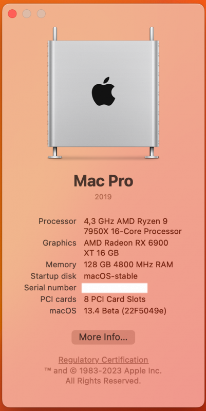

Rox67er Posted April 1, 2023 Share Posted April 1, 2023 (edited) On 3/29/2023 at 8:41 AM, fabiosun said: @Jaidywhen you have some spare time try to understand why this happens 🙂 do Ethernet , WIFI,Bt work well? Just updated to OpenCore 0.9.0 and installed latest AMD kernel patches from GitHub. Update to 13.3 from 13.2.1 was flawless. All seems to be working fine, including BT / WIFI / Aquantia Edited April 1, 2023 by Rox67er Added screenshot 1 Link to comment Share on other sites More sharing options...
