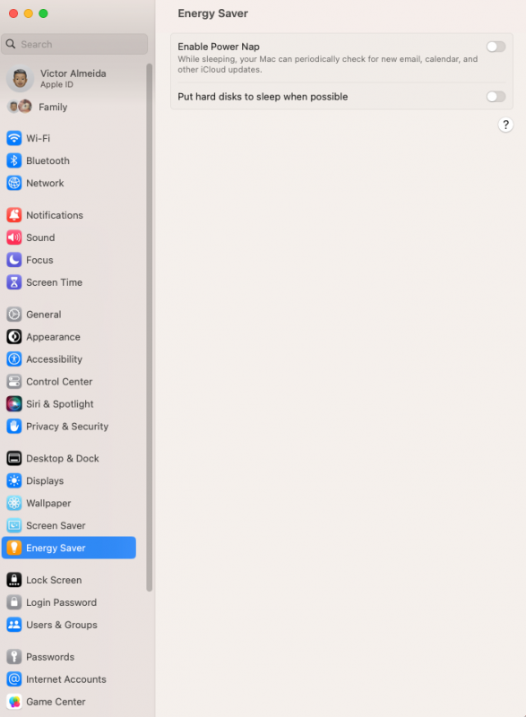

I just did the Ventura 13.1 Beta2 and machine is running like a champ expect it keeps trying to go to sleep even when turn off sleep on the settings.  Is there a way to add something in my configuration to stop the machine from trying to go to sleep.

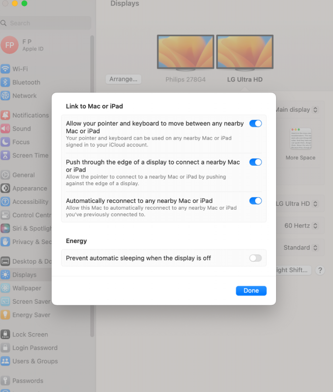

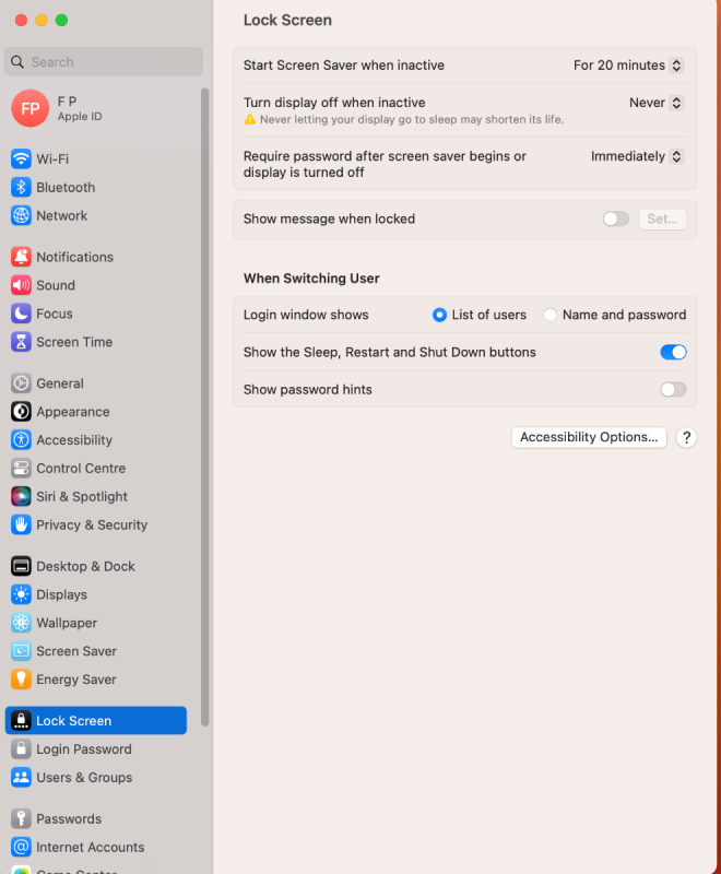

check here
1331850438_Screenshot2022-11-10at5_43_42PM.thumb.png.100b6f3f8e68de1dfb43fcd61b45012b.png
1450552095_Screenshot2022-11-10at5_44_00PM.thumb.png.ba8ebed439ea62ff3b955a94f5d583e0.png
