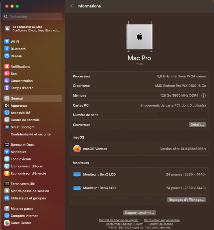

Thanks to @fabiosunand @iGPU for the information that allowed me to successfully install Ventura.
1304840888_Capturedecran2022-06-08a10_57_05.thumb.png.6ab53e2e174dd2b692da4a61777c4764.png
To update on my config:
Disable AvoidDefrag quirk
put old leaf7 patch
maxKernel with 22.99.99 on all patches
-lilubetaall boots arg
I left DummyPowerManagement on True

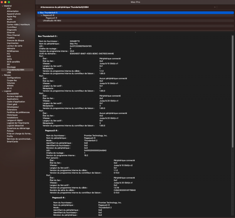

For me the most important is Ethernet and Thunderbolt.
USB adapters work perfectly and so do Thunderbolt peripherals.
ethernet.thumb.png.70650fd5a11883fedad0e33bc9cd51fe.pngthunderbold.thumb.png.48e44026ecd2a3c9a9e487b4ca535fab.png
Compared to Monterey, CPU info is bad (RestrictEvents needs to be updated as @fabiosun said)
The I210 ethernet ports still inoperative (forever 😭).
The IntelBluetoothFirmware kext needs to be updated too. When I connect to Wifi it is directly a wild reboot.
Not tested on sleep, for me it has never worked.

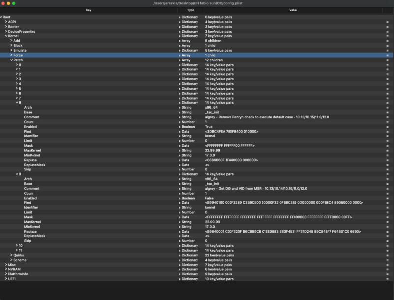

At @fabiosun, I noticed that in my kernel patches, I don't use the 2 patches below
366546737_Capturedecran2022-06-08a11_31_06.thumb.png.b26daf6e4fa23ac65a51e028af7e8796.png
I enclose my bootable EFI OpenCore.0.8.2 for Monterey 12.4 and Ventura.
(Warning, it is not neutral, you have to modify or remove property, MmioWhitelist, number of cores, some kexts , boot-args, CustomMemory, values in PlatformInfo.
EFI OPEN 0.8.2 MONTERY 12.4 _ VENTURA TRX 40 GIGABYTE.zip
yep..in the start of this Ventura's trip i have tested some old patches and i have forgotten to remove them!

@iGPUet @ tous les utilisateurs de thunderbolt
en ventura sans SSDT

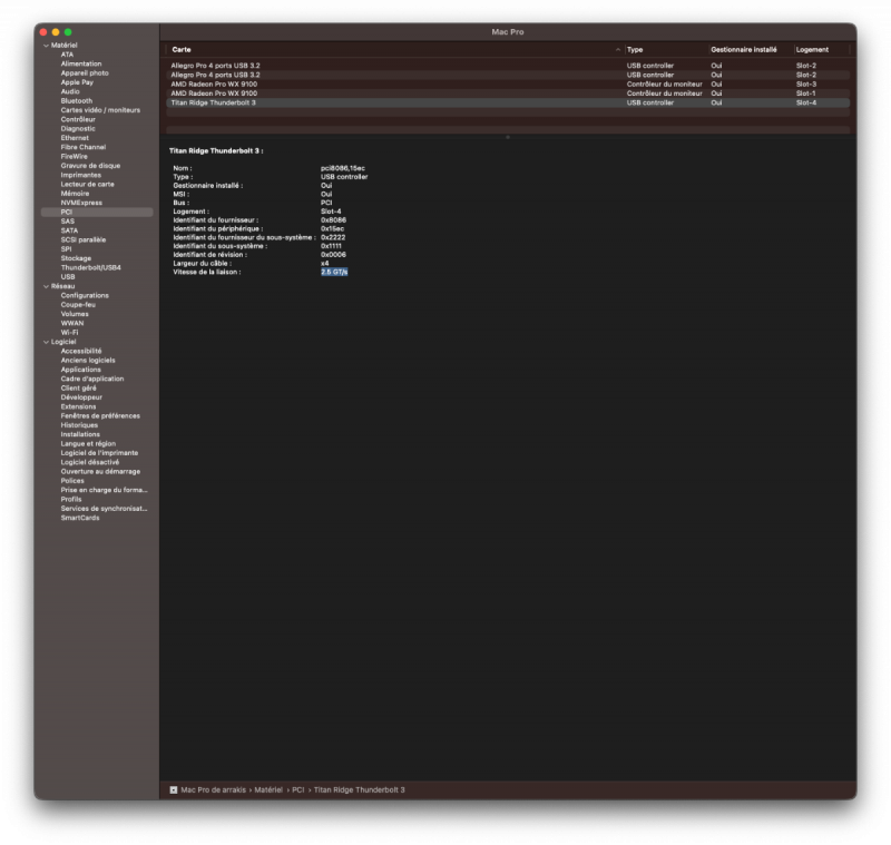

2084438897_Capture d'écran2022-06-09at2_59_35PM.thumb.png.8d2c74b07d8218996d098b2f75944a31.png
jusqu'à 40 Gbit/s de vitesse au lieu de jusqu'à 20 Gbit/s comme dans le système d'exploitation précédent

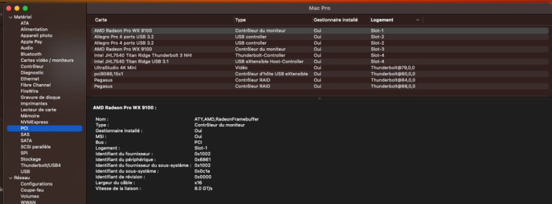

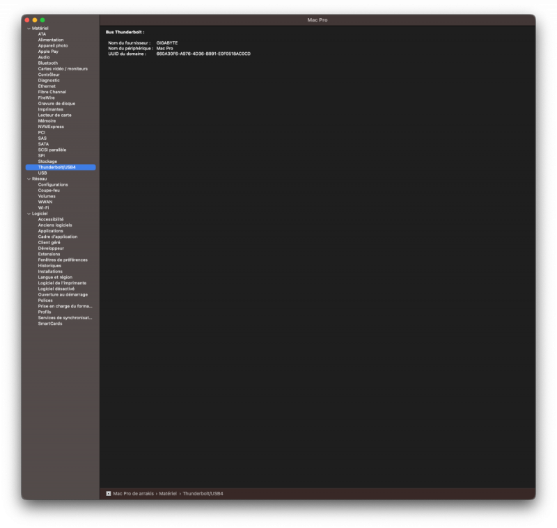

En montage sans SSDT:
@fabiosun On my configuration, the Thunderbolt is not recognized when the SSDT is disabled.
Just the card appears in the PCI information with the USB controller.
See Capture in the spoiler.
I had flashed the Titan board with Mac firmware. Is it the same for you?
1894032064_Capturedecran2022-06-09a18_51_23.thumb.png.588d70ee6762f7cb2f5320e052107ce3.png
209804992_Capturedecran2022-06-09a18_51_59.thumb.png.469fad7fa1e958c2267a9f336e3a977b.png

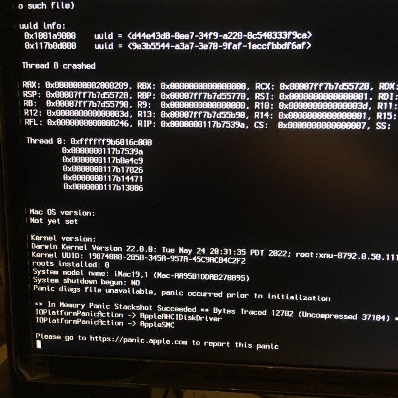

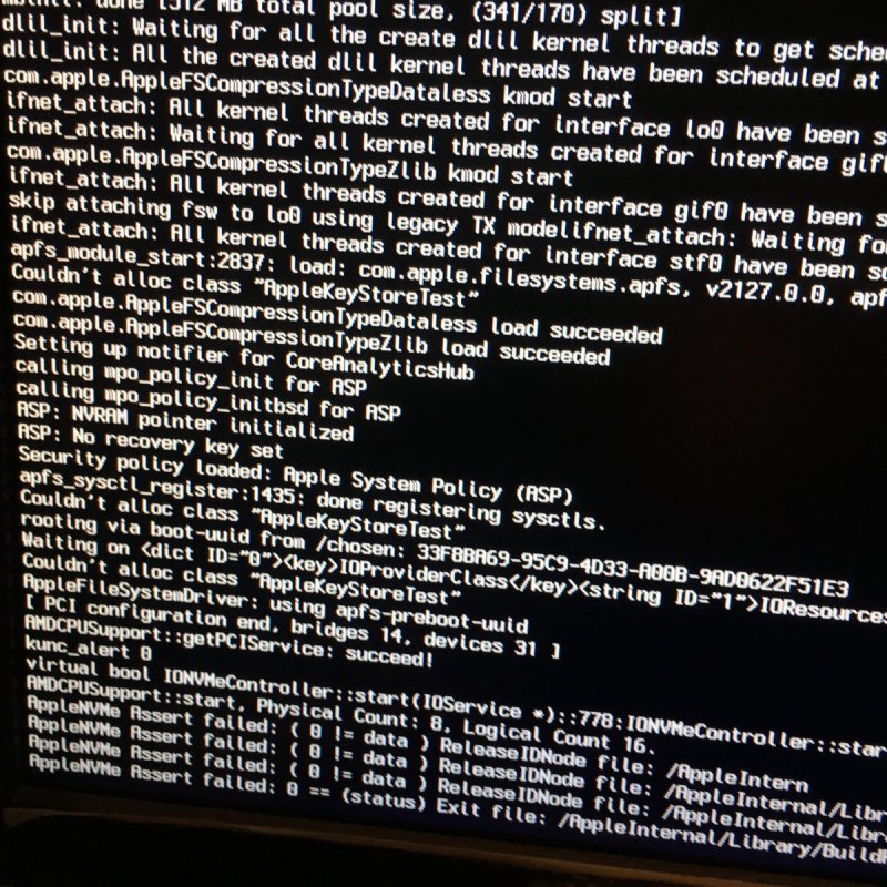

I've done all these things (aside from patches, same set up for Z690). I looked over your config file and we have the same Patches and Quirks.
It continues to fail at about the same point (which is just before log-in; shown in Spoiler below). I'll try to re-install and if that fails, then I'll do a fresh install.
Re-formatting and a fresh install did not help: things still got stuck at the final boot heading to login. More investigation...
Success!
186645135_ScreenShot2022-06-09at9_34_15PM.thumb.png.e83acd8d7e84ddc7d6791d2cfb8f2894.png
The key was adding AppleMCEReporterDisabler kext (which I noted in your config file, fabiosun; thanks!) and disconnecting the Aquantia port.
The AppleMCEReporterDisabler kext file allowed me to boot Ventura, but it would crash before I could complete the sign-in. I thought perhaps an internet issue, so disconnected the Aquantia port and left the AIC ethernet, which I've described early in this thread (it uses the LucyRTL8125Ethernet kext file), connected.
