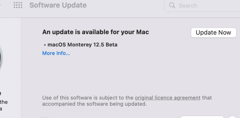

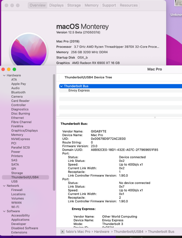

287406314_Screenshot2022-05-18at7_55_50PM.thumb.png.13f2c7a9185a8d42a93d68c37ca69438.png
all is fine with kernel patches again!
Can you test the Aquantia onboard again?
