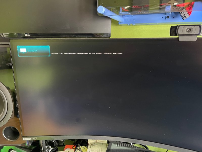

This is only if the machine was all ready registered with Apple then Messenger and Facetime will work. If the machine needs to be registered such as a new install of the OS  it won't allow you because it says it can't communicate with Apple Servers.  I also noticed I get a message before I cant choose the drive to boot from in OpenCOre  The error is No schema for ForceAquantiaEthernet at 20 index , context Quirks
Edited by valmeida
Adde4d picture
