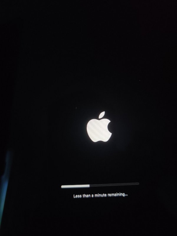

Kennyhack Posted April 15, 2022 Share Posted April 15, 2022 On 4/2/2022 at 11:00 AM, fabiosun said: in your config.plist you have right conversion for MMIO but some are disabled (only latest for must be disabled) attached config.plist enable it and reorganise your kext config.plist declaration if you like backup yours and try @fabiosun After I disabled "Trusted computing" and "LAN" in the BIOS and remove all the RAM (just left 16GB). I was able to get past the "12 Min remaining" And the Computer restarted. Then it started to unpack the installation files and install macOS Big sur. Now I am stuck at "Less than one Minute remaining". Can you tell me, what settings I have to set in the BIOS ? I am using BIOS "FC" I have a Gigabyte TRX40 AORUS PRO WIFI (rev. 1.1 Link to comment Share on other sites More sharing options...
Supervisor fabiosun Posted April 15, 2022 Author Supervisor Share Posted April 15, 2022 @Kennyhackare you using latest config I have posted above? Link to comment Share on other sites More sharing options...
Kennyhack Posted April 15, 2022 Share Posted April 15, 2022 @fabiosun I managed to boot into Big sur. I just had to wait for an hour at "less than a minute......" Thank you for now. I will come back here if I have any problems Link to comment Share on other sites More sharing options...
Supervisor fabiosun Posted April 15, 2022 Author Supervisor Share Posted April 15, 2022 @KennyhackCheck always MMIO in debug (skip 1 for all except latest 4 must be them to skip 0) Link to comment Share on other sites More sharing options...

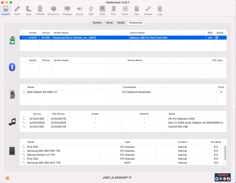

Supervisor fabiosun Posted April 16, 2022 Author Supervisor Share Posted April 16, 2022 2 hours ago, valmeida said: I tried that but the issue is not having the usbc Ethernet adapter binding to EN0 that works as it should. The issue is that it need to show up as builtin so that all the Apple iCloud services to work. please use HackCheck and post file achieved clicking on question mark Also post a pitcure like mine here Link to comment Share on other sites More sharing options...
valmeida Posted April 16, 2022 Share Posted April 16, 2022 1 hour ago, fabiosun said: please use HackCheck and post file achieved clicking on question mark Also post a pitcure like mine here It won't show up in HackChek 1.0.2 but it does show up in the Hackintool. see screenshot . Link to comment Share on other sites More sharing options...
