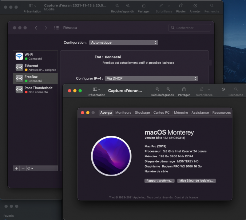

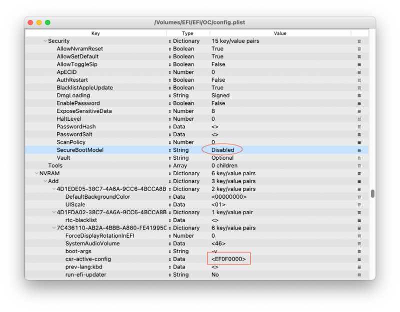

  On 11/12/2021 at 3:23 PM, fabiosun said:
Expand
@fabiosun@Allubz and the others,
I followed the method following the link and it works great: Here
  Reveal hidden contents
Here is the method:
1. Disable the SIP in the config.plist by changing the values as in the spoiler below
2. Switch off, restart and reset nvram. Otherwise the SIP is still activated.
3. Download Chris' Command Line SnapShot Mounter-V2 Here
4. Download Shanee's 2 beta 8 kexts Here
5. Only install the kexts with the Type B command from Chris ’application.
6. Reboot
I still continue to use the I210.kext.
I haven't tried the smaltree but it should work.
I will test the upload connection with large 300 GB files as I usually do at the end of post-production.
After that, there is the surprise of the next update.
Edited :
There is a significant drawback to the method.
Obligation to keep the SIP disabled and SecureBootModel on disabled otherwise it is impossible to boot Monterey where there is a kernel panic with the kext (IOPCIFamily.kext)
I will not use this method.

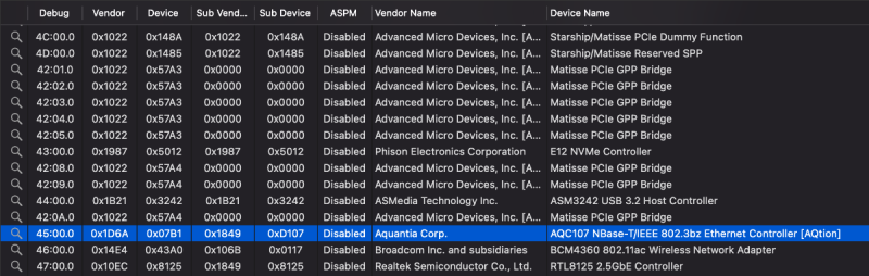

  On 11/9/2021 at 6:54 AM, fabiosun said:
for  ASRock trx40 creator users
You have two ethernet on your motherboard (Aquantia and a 2.5 one)
if you are using Aquantia for sure, it could be useful to post your device id for @valmeidaI think also yours is different from his aquantia id
you can find easily with HackCheck or other tools
See picture below
Thanks
Expand
I seem to have totally different ID's
