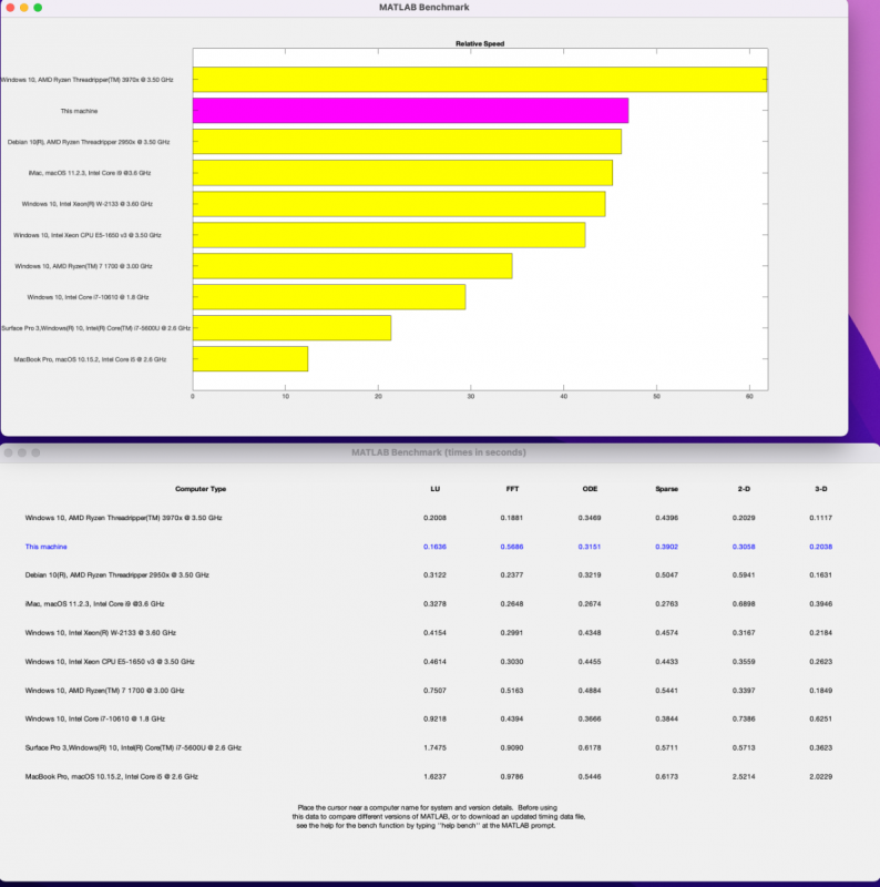

some of you are using Mathematica and matLab apps in OSX/AMD? 😉
2033881534_Screenshot2021-10-31at16_57_37.thumb.png.0a98da131e8be11461f9b1f17267ec3a.png
Thanks @tomnicwork also these two apps working pretty well on AMD rig (osx installation)
I can’t get MATLAB to open on my machine. After a bit of work as per amd-osx, I got it to open up and do a few basic things but never fully functional. Can you please tell us how did you manage to do it?

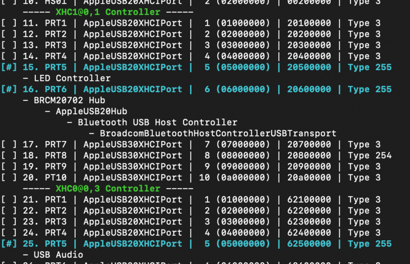

Ive also looked at Rocket88's newly updated USB SSDT and played around with some of the unknown settings zero'ing / disabling, changing port types etc... Its been fun...
BTW Rocket88 Port 18 on the XHC0 (original RHUB name) - the Unknown weird port is a type 254 (not 255)

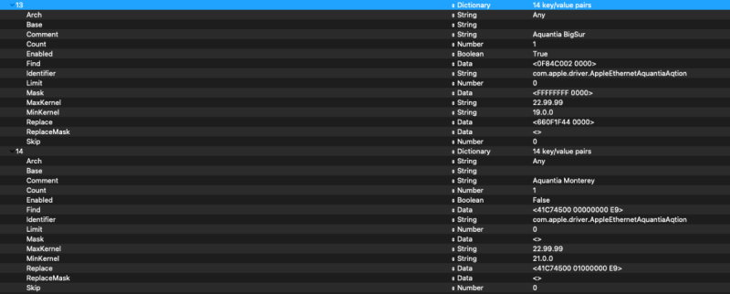

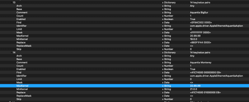

9 minutes ago, Rocket88 said:
Yes it is. I just changed the MaxKernel to 22.99.99 so that it would work for Monterey.
21.99.99 is enough 🙂 I use more for testing
and that patch work for you so?
if you have the same id of @valmeida maybe he can solve his problem
7 hours ago, valmeida said:
Yes is changes the old Big Sur patch to Max Kernel 22.99.99. I also disable the Monteray patch. See attached.

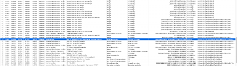

if @Rocket88is using aquantia card with that old patch , the only reason could be his Aquantia has a different id from mine and yours
Or probably he is using other ethernet Asrock trx40 has and that patch is not used at all
