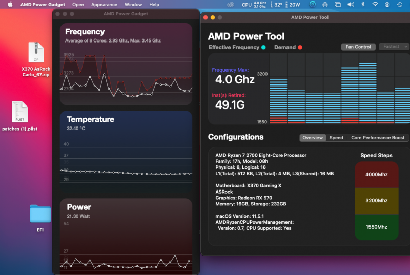

I have the same problem as @iGPUwith the new version SMCAMDPProcessor.kext making my system unstable
and moreover I no longer have the temperature near the CPU in iStat Menus (I use this application because I have GPU temperatures and other constants ...)
I reverted to the previous version. The ExposeSensitiveData value is indeed 8 to recognize my motherboard.

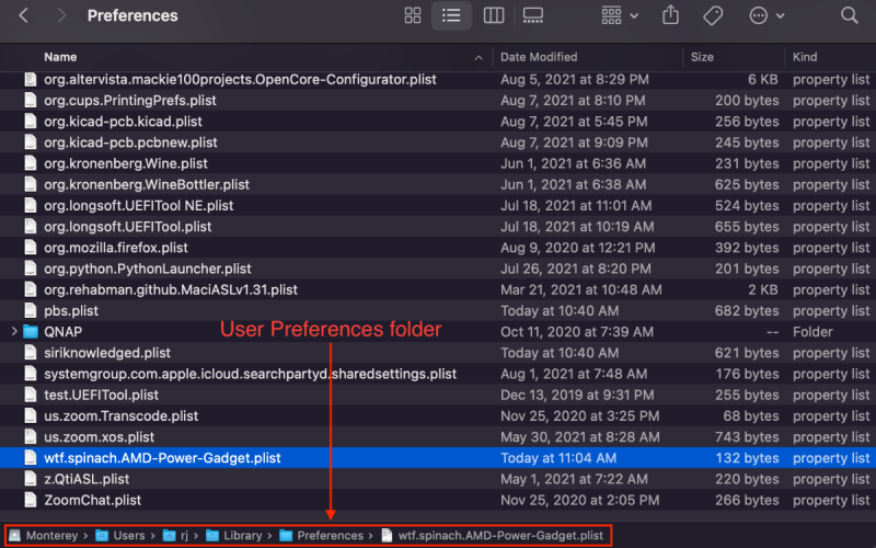

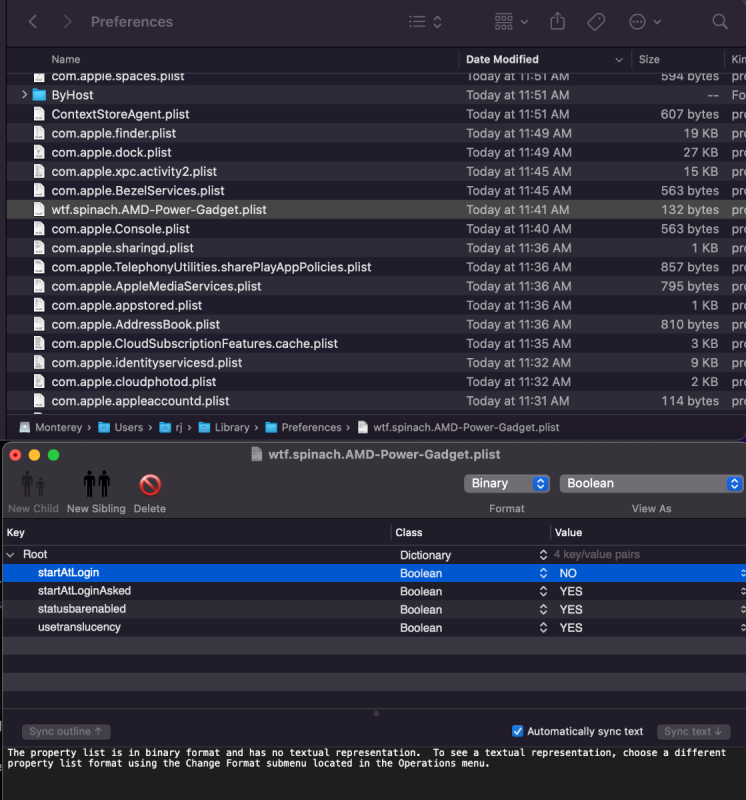

After several more crashes (everything locks up, freezing mouse–––the computer if left alone will re-boot; if impatient, a forced shutdown is required), I think I've isolated the problem...
Each new kext seems okay. I can have a stable computer if one or both are running. I can even run the AMD Power Gadget app and the computer is stable. The problem is if the app has the feature to "Launch in menu bar at login" enabled (StartAtLogin in the plist file discussed below) through it's menu, shown below.
158887305_ScreenShot2021-08-08at12_18_24PM.thumb.png.86402874c199c89a2ed00b7095d4b213.png
Once this is enabled and the computer re-booted, the menu is no longer accessible to disable and now the computer locks up in less than 60 seconds after each re-boot due to the auto-login feature of the AMD Power Gadget app.
I had to boot into Big Sur (or use another EFI where the AMD Spinach kexts were not enabled) to remove the AMD Spinach plist file. This file is located in the User/Library/Preferences folder as shown below. You can either delete it or better is to edit and set "startAtLogin" to "NO" (and while you're at it, also set "startAtLoginAsked' to "YES" to avoid a pop-up window shown in Spoiler below).
212815743_ScreenShot2021-08-08at11_52_40AM.thumb.png.658b34807e046f44beb4dbe2deab0e3f.png

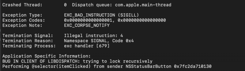

In looking more deeply in the CrashReport log, one can find the following (an excerpt from that log file). I'll provide this info to the developer and maybe they can provide a fix.
2122957755_ScreenShot2021-08-08at11_40_47AM.thumb.png.40aad7dcc8d38b0d39fe1106e1b395b3.png
The bottom line, in its present state, the AMD Power Gadget system is usable (at least for me), if the Auto-Login feature of the AMD Gadget app is not activated.

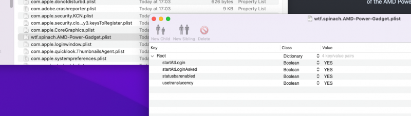

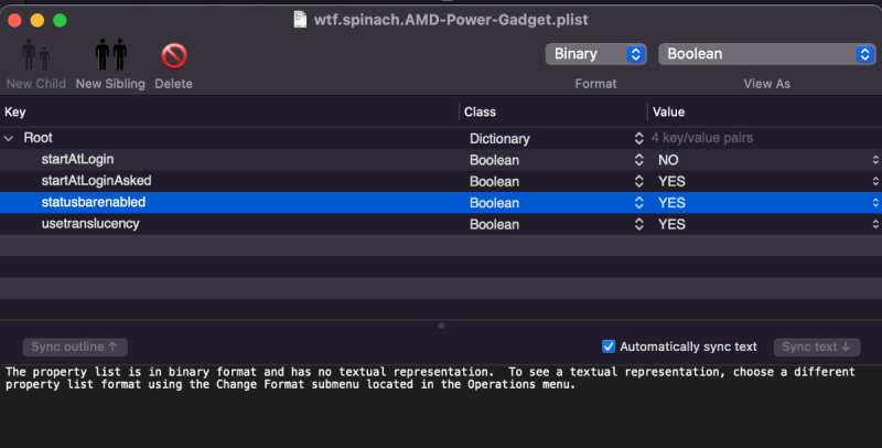

ADDENDUM:
I found out through playing with the wtf.spinach.AMD-Power-Gadget.plist file that the menu is inactivated if "StartAtLoginAsked" is enabled and "statusbarenabled" is set to "YES". I'm leaving "statusbarenabled" set to "NO" in order to have access to the AMD Power Gadget app's menu bar.
After writing the above, the system began locking up even if only the AMDRyzenCPUPowerManagement.kext was enabled (and no AMD Power Gadget app was running). This is after a morning of the computer running fine with both kexts enabled but no app running. It was only after enabling auto log-in did all the troubles start once more. Odd. I've presently disabled both kext files and have contacted the developer.
Menu is inaccessible if "statusbarenabled" set to "YES"!

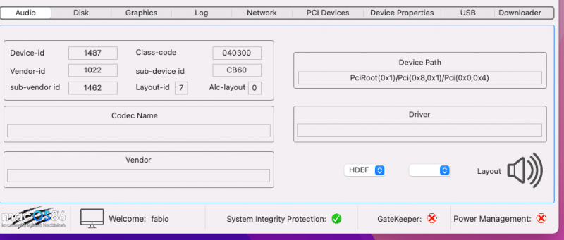

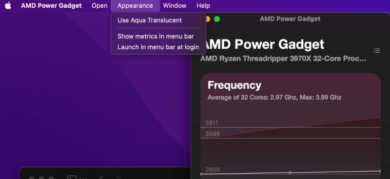

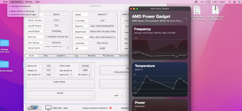

@iGPU
I have enabled it to test..I rebooted
but app does not start in automatic , and to have it running I have to launch via usual icon
..so another bug here
I can't see in location you said any AMDSPinach plist
so maybe other problem here..
I am testing in Monterey b4
EDIT:
SIP Enabled here
475345612_Screenshot2021-08-09at17_00_28.thumb.png.68105cc3459a2d90b4c5d731186298aa.png
EDIT2:
with sip disabled it starts automatically
Let see if it hangs
EDIT3:
Does not hang here and  I can see option to disable automatic app running

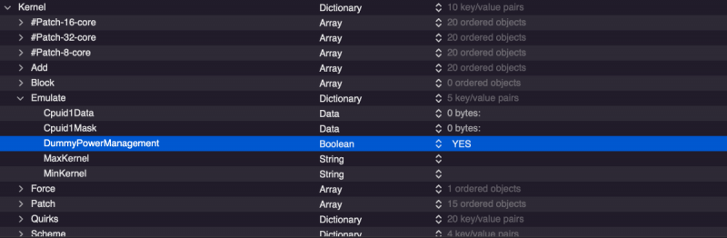

In discussion with the developer, the freezing (hang) problem is solved by simply enabling the DummyPowerManagement quirk (inside Kernel/Emulate as shown in Spoiler).
1184700819_ScreenShot2021-08-10at11_20_37AM.thumb.png.a95c75395f8ed96d89b419c9fb429eb3.png
I'm now of the opinion that, from now on, we should keep this quirk enabled for all TRX40 mobos. (I don't see any downsides to this view.)
There are still issues with the AMD Power Gadget (AMDPG) app having the submenus disappear if "statusbarenabled" Is enabled (plist file location shown below). And I see this menu problem whether SIP is enabled or disabled. This bug needs to be fixed.
But at least now there seems to be no further computer lock-ups when using the AMDPG app!

Using the DummyPowerManagement as an example, while I don't need this Quirk to boot, it now seems to allow me to use the AMDPG app whenever I wish, without having the computer freeze up. Meanwhile, GB mobo owners do need this Quirk. So why not include it as part of a basic, recommended config file for TRX40 users?
3 hours ago, iGPU said:
I do not view recommended settings as mandatory, but beneficial. That is, I view recommended settings as a way of allowing the most users, to have the most trouble-free functionality as possible: the basic common denominator (so to speak) for all.
It's like learning to drive a car: there are many steps and rules that are not always obvious at the start, but end up benefiting most people, allowing for an overall enjoyable experience. Those who later wish to race cars or do stunt tricks will abandon those basic rules and gain more more esoteric knowledge.
Similarly, if we can get a generalized config file that is useful to as many users as possible, giving them an easy, enjoyable experience, then we've accomplished something good for most TRX40 users.
So far, the only unique settings, aside from AIC and specialized SSDT files, are the MmioWhitelist (which is unique for each mobo/manufacturer, and even those have much in common with each other) and Memory configurations (which also can be simplified into 2 or 3 basic settings). Later, those who wish to streamline their config files, can trim the config file, and erase portions, to their heart's content.
I agree with a lot of what you write, on the last part I just ask myself more questions:
1) what has changed in the app and in the kext to be now necessary to activate that quirk (which is quite important regarding power management)?
2) an old question of mine was the correlation between that quirk, the bios versions (MSR) and the patches we have to use..but I couldn't find an answer
However, on this platform the story is still to be written and in part we have all contributed to making some parts clearer.
I also have another question / curiosity
Why does the activation of the dummypower management quirk seem unnecessary here?
I try to explain better, under what conditions the use or not of a kernel patches that seems "unnecessary" to start the system or a quirk like the one mentioned could create a problem, but maybe by activating a simple autologin you can make malfunctioning a system that was basically stable?
As to why the DummyPowerManagement quirk might be important:
The developer asked me to look at the Kernel panic log when the computer froze. I did so and found the following (Spoiler; small extract from end of panic log).
MC4yLjAuMSkgICAgICAgICAgICAgICAgPERBMEVBREQyLTc4QUMtMzkxRS05QTYyLUYyQkNCRTM3QjQyRT4gIC9TeXN0ZW0vTGlicmFyeS9FeHRlbnNpb25zL3B0aHJlYWQua2V4dC9Db250ZW50cy9NYWNPUy9wdGhyZWFkCg==","notes":"Stackshot source : disk","macOSPanicString":"panic(cpu 0 caller 0xffffff801821efa7): CPU 63 has no HPET assigned to it\nPanicked task 0xffffff8829fef6a0: 296 threads: pid 0: kernel_task\nBacktrace (CPU 0), panicked thread: 0xffffff882a5816e0, Frame : Return Address\n0xffffffd1d514bc70 : 0xffffff8016ca34fd \n0xffffffd1d514bcc0 : 0xffffff8016dfcc35 \n0xffffffd1d514bd00 : 0xffffff8016dec603 \n0xffffffd1d514bd50 : 0xffffff8016c42a60 \n0xffffffd1d514bd70 : 0xffffff8016ca38cd \n0xffffffd1d514be90 : 0xffffff8016ca3086 \n0xffffffd1d514bef0 : 0xffffff8017519aa9 \n0xffffffd1d514bf60 : 0xffffff801821efa7 \n0xffffffd1d514bfa0 : 0xffffff8016c4218e \n      Kernel Extensions in backtrace:\n         com.apple.driver.AppleIntelCPUPowerManagement(222.0)[C976299C-7A0C-3F2C-8A3A-524D89DEF7C6]@0xffffff8018219000->0xffffff8018235fff\n\nProcess name corresponding to current thread (0xffffff882a5816e0): kernel_task\nBoot args: agdpmod=pikera \n\nMac OS version:\n21A5294g\n\nKernel version:\nDarwin Kernel Version 21.0.0: Thu Jul 22 19:52:31 PDT 2021; root:xnu-8019.0.72.141.3~2\/RELEASE_X86_64\nKernel UUID: 43AA07BC-5319-3B90-A977-9050C6C2F8D7\nKernelCache slide: 0x0000000016a00000\nKernelCache base:  0xffffff8016c00000\nKernel slide:      0x0000000016a10000\nKernel text base:  0xffffff8016c10000\n__HIB  text base: 0xffffff8016b00000\nSystem model name: MacPro7,1 (Mac-27AD2F918AE68F61)\nSystem shutdown begun: NO\nPanic diags file unavailable, panic occurred prior to initialization\nHibernation exit count: 0\n\nSystem uptime in nanoseconds: 90982254187\nLast Sleep:           absolute           base_tsc          base_nano\n  Uptime  : 0x000000152ef70980\n  Sleep   : 0x0000000000000000 0x0000000000000000 0x0000000000000000\n  Wake    : 0x0000000000000000 0x0000002478dab456 0x0000000000000000\n\n\n"}
To highlight the important part:
 "Kernel Extensions in backtrace:\n com.apple.driver.AppleIntelCPUPowerManagement (222.0)[C976299C-7A0C-3F2C-8A3A-524D89DEF7C6]@0xffffff8018219000->0xffffff8018235fff\n\nProcess name corresponding to current thread (0xffffff882a5816e0)".
He suggested that the problem with the freeze was probably due to macOS's Intel PM (power management), which would require the DummyPowerManagement quirk to be enabled to fix the kernel panic. I tried this and found that by enabling this quirk, the crash (kernel panic) stopped.
