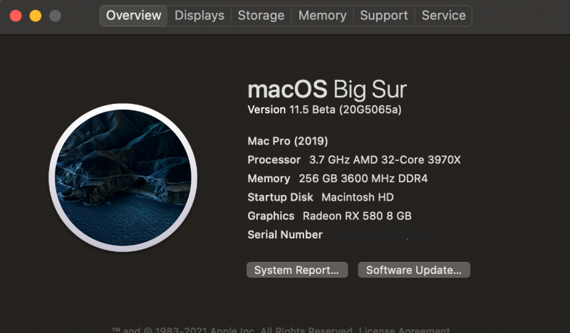

Moderators iGPU Posted July 9, 2021 Moderators Share Posted July 9, 2021 (edited) 3 hours ago, Ploddles said: Anyone tested the new patches with Big Sur 11.5 Beta 5? Not that I am expecting any changes now in the latest beta released today so they should be fine. This will probably be the last update, bar any further security updates, to Big Sur before we move on to Monterey. This update went fine with new patches (using the minimal ones I uploaded last night). RestrictEvents injects the Processor info shown below in the "About This Mac" window (with code in Spoiler). Spoiler Edited July 9, 2021 by iGPU 1 1 Link to comment Share on other sites More sharing options...

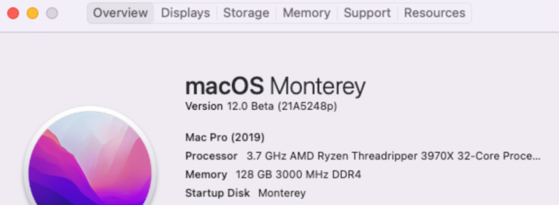

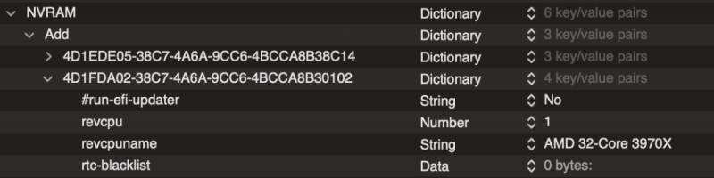

Ploddles Posted July 9, 2021 Share Posted July 9, 2021 17 hours ago, iGPU said: This update went fine with new patches (using the minimal ones I uploaded last night). RestrictEvents injects the Processor info shown below in the "About This Mac" window (with code in Spoiler). Reveal hidden contents I get this (BS and Monterey) without the revcpu or revcpuname entries as per your spoiler, so I am assuming it must be reading it from the BIOS. Link to comment Share on other sites More sharing options...

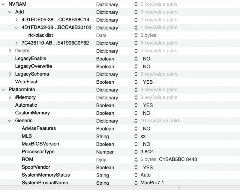

Moderators iGPU Posted July 9, 2021 Moderators Share Posted July 9, 2021 1 hour ago, Ploddles said: I get this (BS and Monterey) without the revcpu or revcpuname entries as per your spoiler, so I am assuming it must be reading it from the BIOS. Are you using the RestrictEvents kext? And what value are you using for PlatformInfo/Generic/ProcessorType? Link to comment Share on other sites More sharing options...
Ploddles Posted July 9, 2021 Share Posted July 9, 2021 (edited) 49 minutes ago, iGPU said: Are you using the RestrictEvents kext? And what value are you using for PlatformInfo/Generic/ProcessorType? Yes, this is with RestrictEvents. Processor Type = 3842 Edited July 9, 2021 by Ploddles Add picture Link to comment Share on other sites More sharing options...

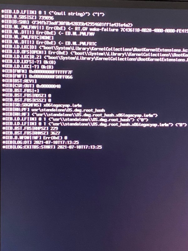

Ploddles Posted July 10, 2021 Share Posted July 10, 2021 The one that does work for me at the moment is :- config.plist.zip If I just replace the patches section with yours then the system stops as in above image. If I also change the various quirks sections as well it stops at the same place. Link to comment Share on other sites More sharing options...
Supervisor fabiosun Posted July 10, 2021 Author Supervisor Share Posted July 10, 2021 On 7/10/2021 at 11:11 PM, Ploddles said: The one that does work for me at the moment is :- ---- If I just replace the patches section with yours then the system stops as in above image. If I also change the various quirks sections as well it stops at the same place. try this with your EFI I have disabled few patches and added 0 ones UPDATE 17-07-2021: Link to comment Share on other sites More sharing options...
Ploddles Posted July 10, 2021 Share Posted July 10, 2021 @fabiosun I booted with verbose mode each time. A clean install of BS 11.5 beta 4, updated to beta 5, worked fine for 5 minutes before I restarted for the next test. Older install of BS 11.4 with all my programs installed:- 1st start panicked and automatically rebooted shortly after entering my password and before loading my desktop, menu bar or dock. 2nd start locked up a few minutes after startup. 3rd start worked ok for 5 minutes before I restarted to test Monterey. Monterey seemed to start but never displayed the log on screen. I left it for a few minutes but it didn't reboot or ever display anything on the screen. I rebooted and the same thing happened. 3rd reboot was the same. Link to comment Share on other sites More sharing options...
Supervisor fabiosun Posted July 11, 2021 Author Supervisor Share Posted July 11, 2021 @Ploddles better or no? 🙂 about Monterey but also other system Whatevergreenkext should be disabled or "boot argumetated" well 🙂 if you are using 6900 xt otherwise black screen when login should happen Link to comment Share on other sites More sharing options...
Ploddles Posted July 11, 2021 Share Posted July 11, 2021 It is about the same for Big Sur. Worse for Monterey as I just get a black screen. I tried with and without whatevergreen.kext, it makes no difference. With my old patches I do get an output to my screen. 1 Link to comment Share on other sites More sharing options...
