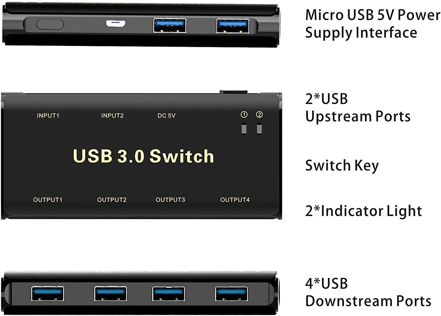

Support Team iCanaro Posted September 4, 2020 Author Support Team Share Posted September 4, 2020 forse ho raggiunto la pace dei sensi con kvm switch https://www.amazon.it/gp/product/B089NH9BL1/ [24,99€] Spoiler Cavi DP 8K 30Hz 4K 144Hz https://www.amazon.it/gp/product/B07YW6QXQT/ [14,99€] Spoiler per mouse e tastiera https://www.amazon.it/gp/product/B07WMG6LB7/ [18,69] Spoiler Monitor 4K UHD in condivisione tra Z370 e T-RyZo https://www.amazon.it/gp/product/B07SL5KB3H/ Spoiler preso da ama warehouse a 285€ 1 Link to comment Share on other sites More sharing options...
