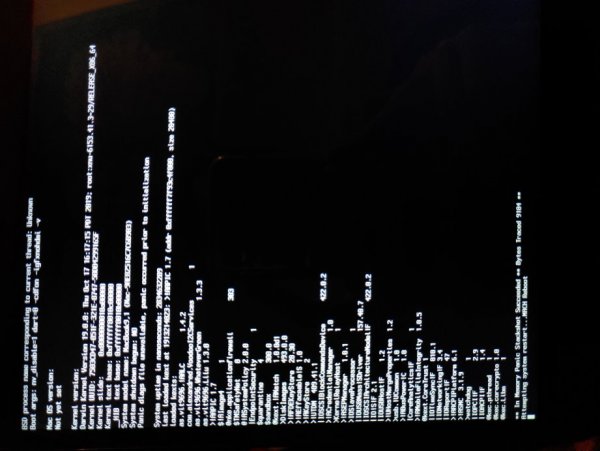

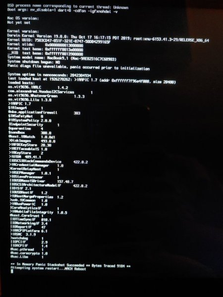

Mattia27c Posted November 11, 2019 Share Posted November 11, 2019 @Gengik84 Ho provato in diversi modi, ma sono sempre nel kernel panic col DSDT patchato inserito.... Link to comment Share on other sites More sharing options...
Administrators Gengik84 Posted November 12, 2019 Administrators Share Posted November 12, 2019 Non capisco allora come hai fatto a postare un ioreg col dsdt. Allega la foto del KP avviando in verbose Link to comment Share on other sites More sharing options...

Mattia27c Posted November 13, 2019 Share Posted November 13, 2019 @Gengik84 Link to comment Share on other sites More sharing options...

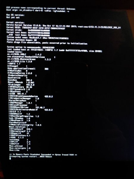

Administrators Gengik84 Posted November 20, 2019 Administrators Share Posted November 20, 2019 in questa efi Sostituisci nel caso allega ioreg Archivio.zip Link to comment Share on other sites More sharing options...
Mattia27c Posted November 20, 2019 Share Posted November 20, 2019 @Gengik84 ho sostituito ciò che mi hai indicato, ma va sempre in panic Link to comment Share on other sites More sharing options...
Administrators Gengik84 Posted November 20, 2019 Administrators Share Posted November 20, 2019 nessun path se non minima per I2C mi viene il dubbio che il problema sia proprio li riesci a fare foto precedente a quel punto? Link to comment Share on other sites More sharing options...
