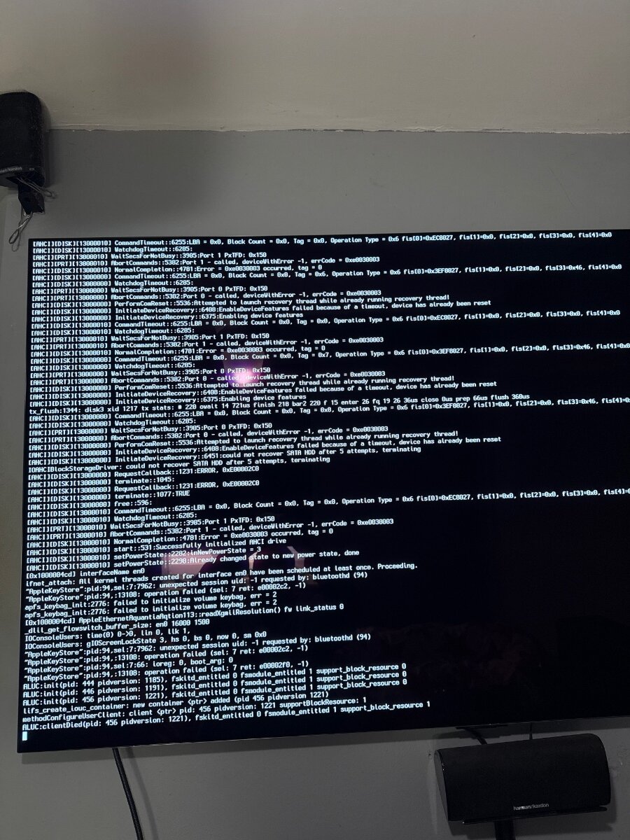

So it seems to be stuck at AppleKeyStore:pid94,:13108 operation failed (sel: 7 ret: e00002f0, -1)
it installed find this was after it rebooted
rebooted again and now stuck at

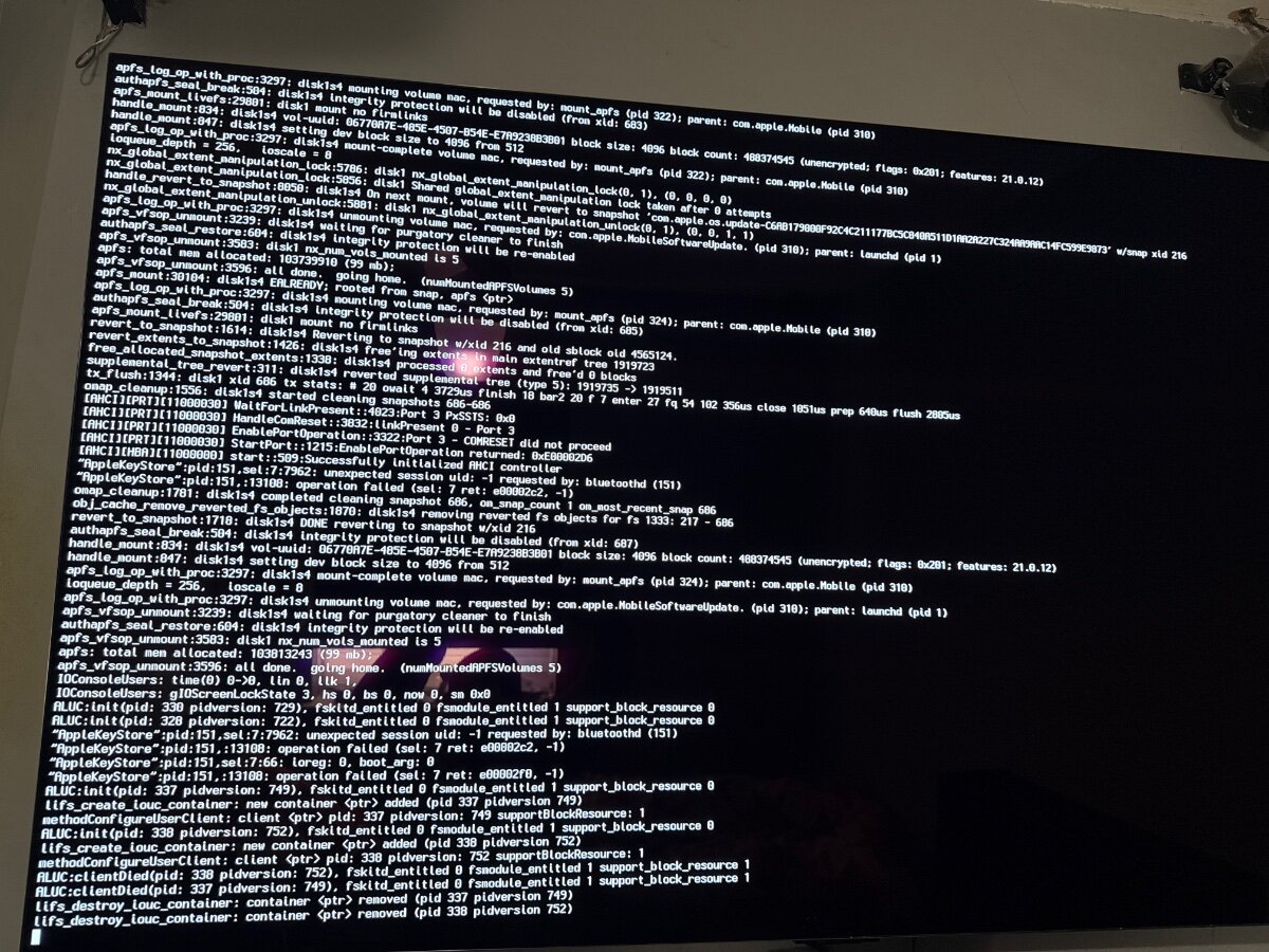

It’s seems to vary where it stops I’m reinstalling just in case something went wrong and then if not I will try the above file and report back
thank you
edit:
now gets stuck here constantly
Edited by khile
