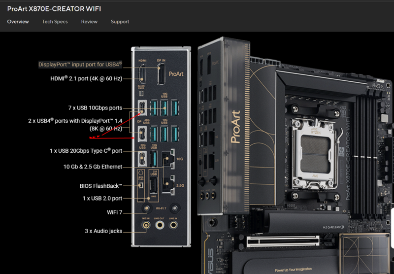

17.06.2025 tarihinde saat 12:25'te dny87 şunu söyledi:
@WeKinG
Bir X870E Proart Creator'ım var, her şey yolunda çalışıyor ancak bir Universal Audio Apollo Twin X'im var ve çalıştıramıyorum😞
Windows'ta ona şey çalışıyor
hello dny in order to run apollo you need to have your soundcard plugged in and turned on while your computer is off.then turn on the mac and install it.it may ask you to restart again after each usb eject or fw update.but you can use it this way.it is defined as coldboot.
Edited by WeKinG
i tried that option but nothing works for me, the asus proart x870e creator has the ASM3242 not the ASM4242. Is it possible that it does not work because i have installed 4 nvme ssd´s and the pci card for wifi and bluetooth ?
I think you should first try to run apollo from type-c on window and if it works then try it on mac.
if it works in win then try if the usb ports work, especially the type c port which is usb 4.0
I may be wrong, but when you use pci cards, certain pci buses are disabled, so the last resort is to remove the additional cards and try.
Edited by WeKinG
I just saw ASM3242 | USB 3.2 Host Controller 20G
this is not usb 4.0, probably because of this problem.
because thunderbolth support came with usb 4.0
your mother board have 40g type c port try this port
This device will not work if you plug it into 20g slots.
Finally, make sure your type c cable supports thunderbolt or usb 4.0.
Edited by WeKinG
in windows the apollo works without any issues. i plugged it into the first usb 4.0 port. i use a thunderbolt cable for it. i will try it without the pci card..... doesn´t work
Edited by dny87
If your usb c port works on mac, try connecting another device.for example usb drive etc.
