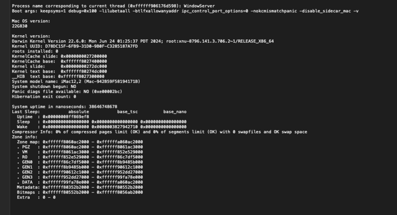

fabio8v Posted August 19, 2024 Author Share Posted August 19, 2024 (edited) si, potrebbe interessare il resoconto del perchè si blocca? Edited August 19, 2024 by fabio8v Link to comment Share on other sites More sharing options...
Support Team Carbo Posted August 19, 2024 Support Team Share Posted August 19, 2024 Immagino di sì Link to comment Share on other sites More sharing options...

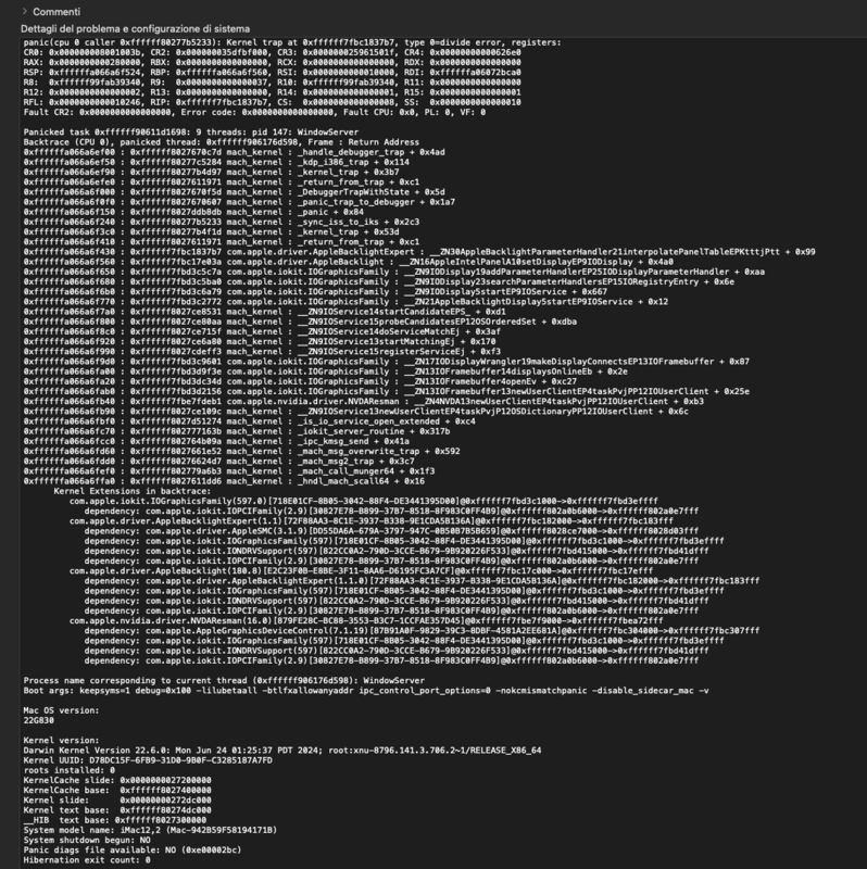

fabio8v Posted August 19, 2024 Author Share Posted August 19, 2024 ecco Link to comment Share on other sites More sharing options...
Support Team Carbo Posted August 19, 2024 Support Team Share Posted August 19, 2024 Niente, panic dovuto alla grafica. Riavvia in safe mode e prova a lanciare OCLP Link to comment Share on other sites More sharing options...

fabio8v Posted August 20, 2024 Author Share Posted August 20, 2024 Buongiorno, si blocca 2 righe prima nella schermata che ho postato all'inizio Link to comment Share on other sites More sharing options...
Support Team Carbo Posted August 20, 2024 Support Team Share Posted August 20, 2024 È un blocco come quello in prima pagina o un kernel panic? Link to comment Share on other sites More sharing options...
fabio8v Posted August 20, 2024 Author Share Posted August 20, 2024 lo stesso della prima pagina Link to comment Share on other sites More sharing options...
