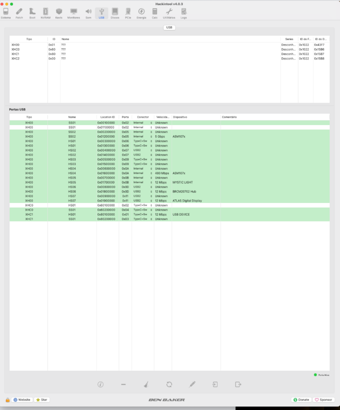

Hi Fabiosun,
The BRCM is an old one (working perfectly), but it needs to be plugged in an usb2.0 port at the motherboard
And the Atlas is a LCD Display of the case.
Something is wrong with the USB mapping because when I plug something in one or two back ports it disconnects my External Hdd plugged into another one, and my continuity camera of the Iphone doesnt work also at the type-c port
And the last problem is that when I shutdown the PC it doesnt shutdown, it reboots.
I dont know if you know a brazilian Youtuber specialized in Hackintosh named Gabriel Luchina, but he had exactly the same problem in one computer that he made the hackintosh and solved the problem, but he’s not trying to help unfortunately, only sell his full install support
Edited by lfbaptista
I had one and internal usb2 port of your motherboard should be mapped as internal

2 hours ago, lfbaptista said:
How do I map the BRCM as internal port? Where do I change this? (I’m new here at hackintosh)
your USB for BT seems to be in XH00/HS06
in the left you see USBconnector set to 0
0 means USB2
3 means USB3
9 means typec
255 means internal
